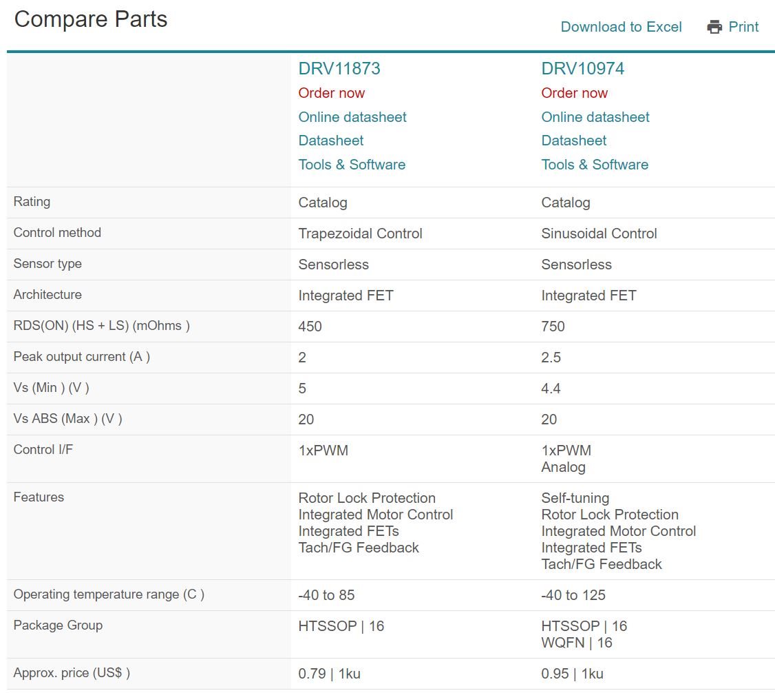

    Q2) For our application, what are the reasons for using the DRV10974 over the DRV11873?
    A2) To get a quick overview of DRV11873 vs DRV10974, please look at the comparison below from ti's product comparison tool. You can see for example from the table that you would use DRV10974 over DRV11873 if you wanted to control speed with an analog voltage instead of pwm.
    Note: If/when evaluating the DRV10975, which provides the most flexibility in tuning, I would recommend starting with this template conservative settings, and change the kt and resistance parameters in the settings for your specific motor.
