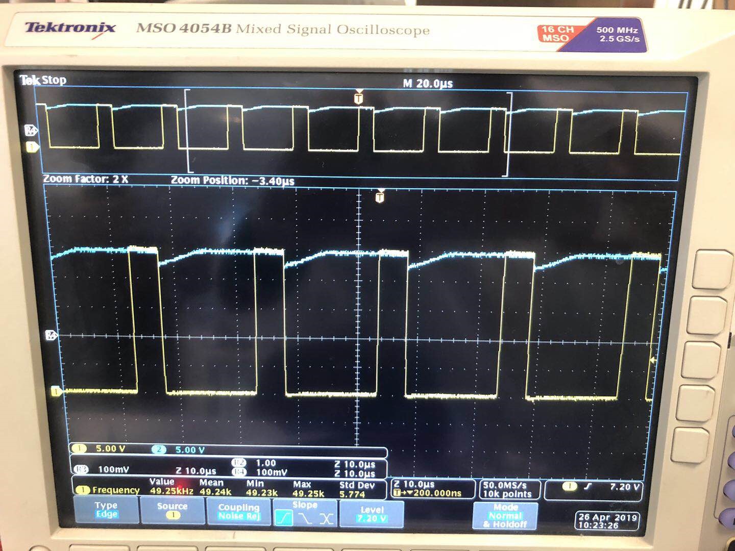

One of our customer has done some test with our DRV8860 on their prototype board (follow EVM circuit). DRV8860 is design to drive the valve. They have observed channel crosstalk when driving in one channel . In the below waveform, one channel is PWM switching, an adjacent channel is connected to a valve but in off state.
Can you help to comments what could possible lead to the 'dip' on the adjacent channel and any remedy we could try ?

    b. The issue is happened at PWM Channel's falling edge. Different channels share the same ground. Each channel's gate voltage reference to same ground. At PWM channel's falling edge, the ground current is reduced from PWM FET to common ground. The ground trace voltage is changed the polarity to "Ground "+" and FET source" -". If the ground parasitic inductance is high and this ground voltage jump may affect other channels.
    So, please help me check the IC ground connection between VM local ceramic capacitor ground and IC ground on their layout.

    Customer has shared the layout as below, they have tried to follow the EVM layout and uses 10uF + 0.1uF for the filter cap. I have also arranged one evm for customer to verify if it has similar issue.
  • Don,
    Thank you for your update. The layout near DRV8860 looks good.
    Would you measure the VM voltage waveform to see if it has same drop as the output? I have to take back my comment before. Ch1 is falling edge is low side FET current rising edge. So, the current is pulled out from input source. If the input source is not strong, we could see the input voltage drop which reflects to all output voltage.

    I have tested the evm with resistive load, no cross talk found.
