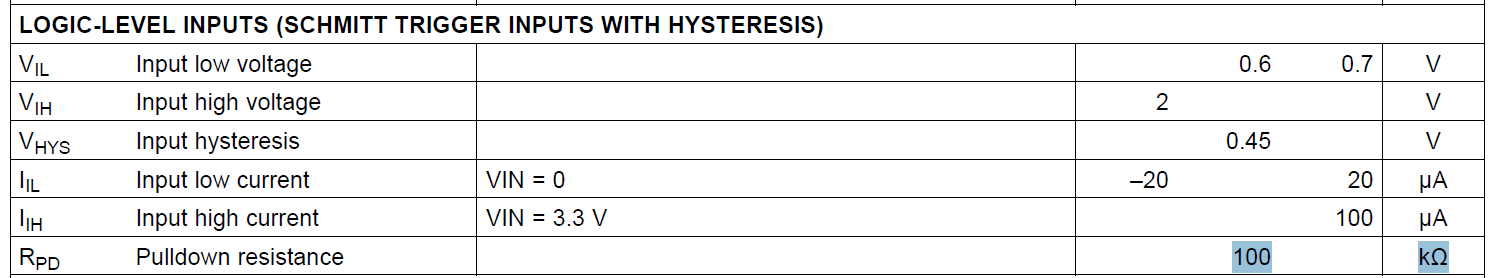

DRV8803: What happens if some inputs are not connected
Part Number: DRV8803
In my next PCB I well use the DRV8803 16-pin HTSSOP again, but instead of using all 4 in/outputs I only need two.
I was not able to find any circuit recommendations in the datasheet if some in/outputs are not connected. Would it be better to connect the not connected inputs to a pull-down circuit, so there is no floating?
