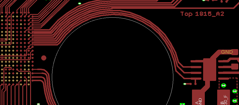

My design pulls nFault to 2.5V through a 10kΩ resistor.
When there is no fault, the voltage at nFault is only 1.7V.  This implies 80µA leakage.  The spec says 1µA max at 3.3V.
I can see nFault fall to 0v when the input voltage falls below 6.3V, so it appears to be functional.
Is it possible the leakage is that much higher at 2.5V?
Should I be using a lower resistance pull up?  The data-sheet has not recommendation.  The EVM uses 10kΩ, but it pulls up to 5V.

  •  The only way would be to cut the trace or possibly lift the pin.
    You can see the trace travel around the hole in the board from the DRV8872 to the FPGA pin.  That is the pull up resistor just below.
    You can also see the control signal running from the same bank on the FPGA to the DRV8872.
    (This bitmap render of the traces is pretty "crunchy" and they look like they touch.  You'll have to trust that the gerbers are fine.)

    Understood. I would not recommend cutting the trace. Lifting the pin and wiring a pullup on the pin may be an option, but you will have to make that call. It appears your PCB is much more complicated.
    What is the supply voltage of the FPGA? What is the VOH of the FPGA IO pin?
  • That I/O bank of the FPGA uses the same 2.5V supply. You would like to have 2+ volts.
    I may try lifting the pin and attaching a new resistor, but it will be a few days until I can make that happen.
