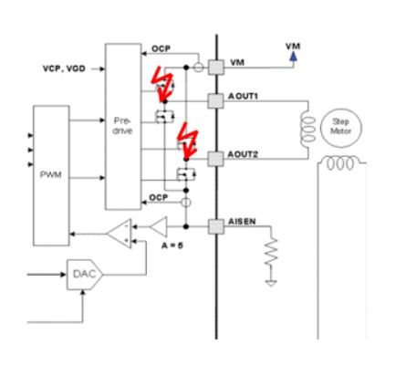

Hi
According to EN60335 19.11.2f we have to consider an integrated circuit as a black box.
Can it be happen that  VDD of the DRV8824 is directly connected to 2 winding outputs due to an internal fault in the part.
For example:
The short circuit which would cause issues in our case would be a short from VMA to A/Boutx or from VMB to A/Boutx
Best wishes;
Olrik

  • Hi Wang,
    it's not of external failures around the part, it's when the part fails by it self. Can there be internal shorts if the part becomes somehow damaged from an inputvoltage pin to the outputs ?
    What's the behaviour of the internal FETs in case of a failure - can they get short ?
    See attached
    It's a requirement driven by VDE regularities that in failure condition it couldn't be happen that a inputvoltage has a short to the output.
    Best wishes,
    Olrik

  • Olrik,
    The FET damage could be shorted or opened when VM pin is overstressed. I think when the system senses the failure condition and motor driver is damaged/out of control, the system should add another layer independent protection to protect its self.
