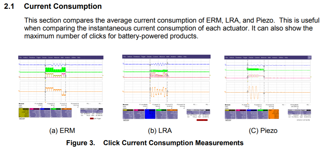

There are several question about DRV2605.
1.Is the output of DRV2605 sinusoidal or square? Is there a selection mechanism or how to set it up?
2.Waveform 1 and 3 in LRA Library of ROM. The values of OD_Clamp and Rate_Voltage registers are unchanged. I observed on the oscilloscope that the voltage amplitudes of the two waveforms are similar, but the waveform density of 1 is just higher than that of 3. But the data sheet says that 100% is higher than 30% of the voltage. What is the reason for this?
3. In the case of LRA mode and internal trigger, I2C communication. Can the output voltage amplitude be modified by OD_Clamp and Rate_Voltage registers when the waveform is output?
4. Are there some Reference materials  for the registers' settings and Waveforms?

    1.- The output of DRV2605 is a differential PWM form that depend of the analog input. In order to get a sinusoidal output waveform, I would suggest to use an external RC filter (100Kohms, 470pF). This will filter the high-frequency content of the PWM signal to measure or analyze it with the help of a scope.
    2.- The OD_Clamp and Rate_Voltage don't affect the LRA library effects. These parameters are only used for other modes such the PWM and RTP modes. The library effects are predefined waveforms and the OD_Clamp and Rate-Voltage won't have any effect. The only parameters that can be modified are explained in the 7.3.5.2.2 section of datasheet ( www.ti.com/.../drv2605.pdf ).
    3.- Yes, in this case, these parameters can be modified and they will have an effect at the output.
    4.- Yes, please take a look at the following links:
    www.ti.com/.../sloa189.pdf
    www.ti.com/.../sloa194.pdf
    www.ti.com/.../getliterature.tsp
