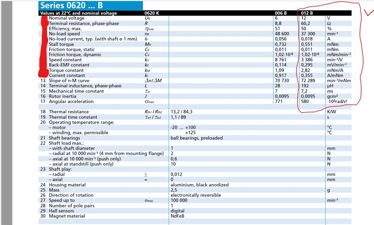

Hello guys,
I have a motor whose parameters are described in the attached picture. The motor phase to phase resistance is 60.2OHM which after dividing with 2 will be 30.1 for phase resistance according to the tunning guide. Now my question is " can I run this motor with DRV10983Q1EVM or DRV10983Q1 Chip or not? "Is there any way to run this motor because I already designed my board with DRV1093Q1. I also have DRV10983Q1EVM board for testing purposes. Thanks
