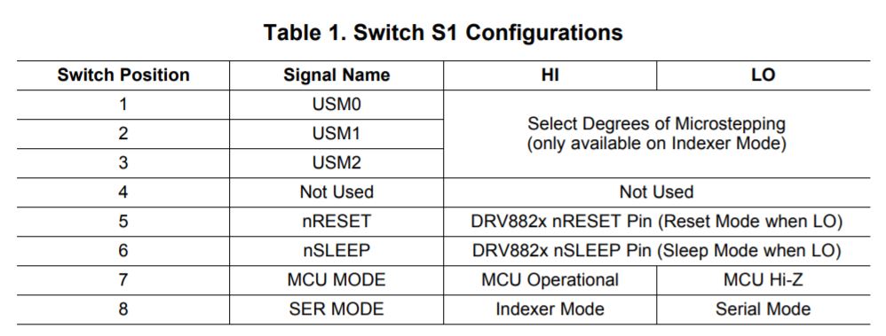

1. Regarding the switch S1.
    How to set S1 when I want to use MCU and GUI(Application for DRV8829 EVM)?
    My understanding is S1-7:High and S1-8:Low.
    Serial mode is always need Low?
2. Regarding when I set the switch S1 is S1-7:High and S1-8:Low.

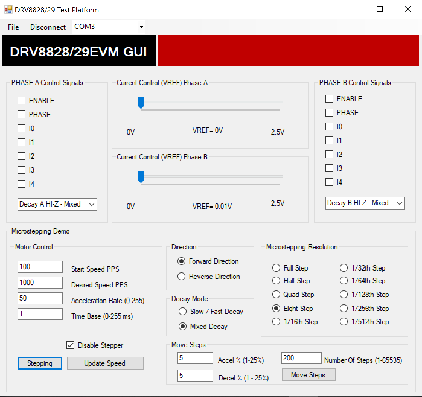

    2-1 : When all check boxes were cleared in the Control Signals, the motor moved when the start steps button was pressed the in Stepper Control Screen.
             Is this normal work?
   2-2 : When Enable check box were checked in the Control Signals, a current of about 4.5 A flowed to the Vout terminal.
            Why does the current flow? Is this normal work?
  2-3 :  Can I control a current flow in the Control Signals screen?

    1.  Yes. On my bench EVM, S1-7:High and S1-8:Low. The motor can run.
    2. 2-1: After I connect USB cable to PC,; connect motor to output; add input voltage to VM and click "Start Steps" in GUI. The motor can run normally.
    2-2: with the following setting the 12V input current is about 0.7A.
    2-3: When I click "Current Control (VREF) PHASEx", the input current goes up very high. That may match your side 4.5A.
  •  Kengo,
    2-3: I am not able to control the current flow in the Control Signals screen with S1-7:High because it is MCU HiZ mode. But, I can control the current by adjust the potentiometer R19.
    If S1-7 is set to low, I can use Control Signals screen to adjust the current setting.
    3. Please set S1-7 MCU HiZ mode. And then, use your own MCU to control this EVM.

    Could you give me your advice for more detail about my question No2(2. Regarding when I set the switch S1 is S1-7:High and S1-8:Low.).
    I could not control the current even if I choose at the control Signal screen.
    Are there any precautions or something to do?
    About the current control(VREF) Phase x,
    Do I need control the Potentiometer to move this setting?
    About the Move Steps,
    Sometime it keeps moving.
    Are there any problems with the settings?
    Or is it a bug?
    Sincerely.
    Kengo.
  • Kengo,
    When you set S1-7 high, you make the onboard MCU on HiZ mode.  So, You could not control the current even if I choose at the control Signal screen.
    If you want to control the current with GUI, please set S1-7 low. The the Potentiometer can also move the current setting.

  • Kengo,
    After you sets S1-7 high, do you change the Ix setting to control the current?
    When I change Ix setting, I can measure the Ix test point voltage change. That controls the current setting.

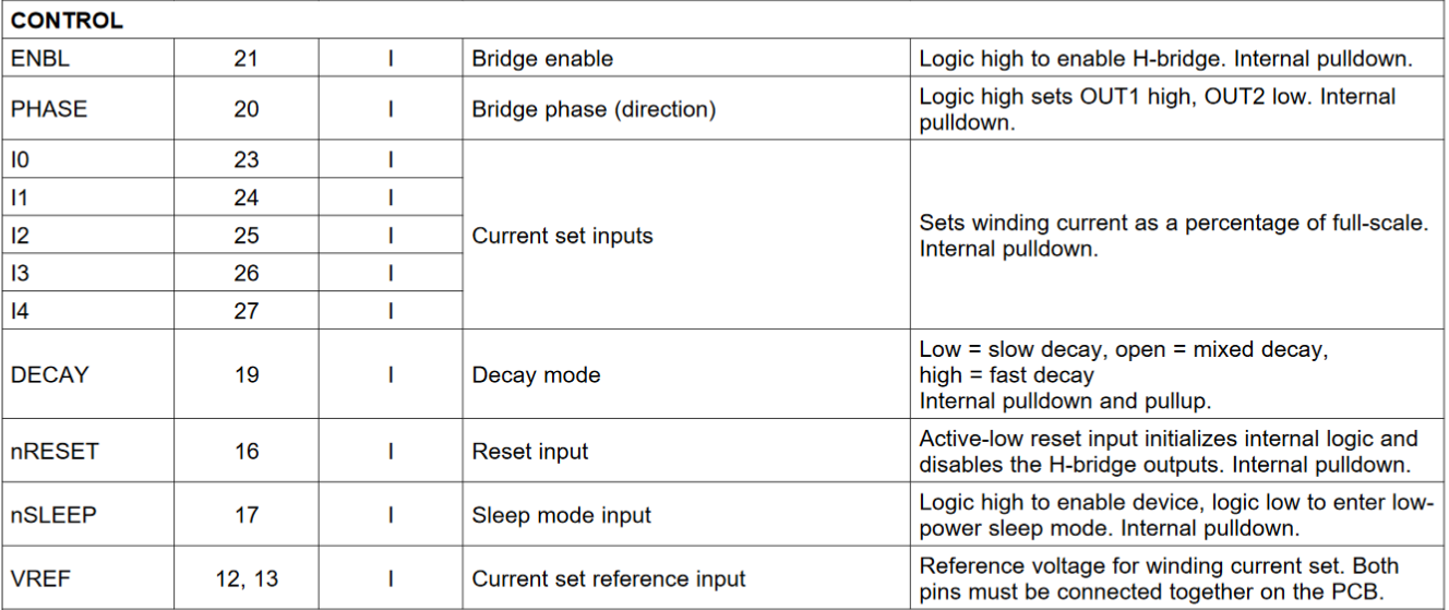

  • Kengo,
    1. Does the VREF need voltage when S1-7=Low(MCU-HiZ)?
    It is related to the external MCU control signal. On the EVM, I saw Ix pin test voltage is 3.3V when S1-7=Low. If the external MCU doesn't have pull-up capability, the VREF is needed.
    2. If it so, when can I use the potentiometer(R19).
    Yes. You can use R19 to adjust the current.
    3. Do I need control GUI and potentiometer (R19) when S1-7=High and S1-8=Low(serial mode) .
    When S1-7 is high, you can control GUI Ix or potentionmeter R19 to control the current.
    4. When S1-7=Low(MCU Hi-Z), where should I put the input signal at least?
    Yes.
    5. When S1-7=Low(MCU Hi-Z),does the MCU(MSP430) supply the signal somewhere?
    No. The on board MCU is on High-Z mode.
    If R19 sets the reference high and Ix pins are all high, you could see a high current.

  • Kengo,
    "4. When S1-7=Low(MCU Hi-Z), where should I put the input signal at least?"
    Put your own controller's signals on the test points.
    "5. Which pin do I have to input the signal at this time?"
    For the following control signals, you need to control. I measured those pins test points were 3.3V when S1-7=Low(MCU Hi-Z), So, if you don't add control signals, it may be 3.3V.

    Regarding the Move Steps in GUI,
    Sometime it keeps moving when I set 200 steps or other step.
    Do not stop the Move Steps.
    Or is it a bug?
    I don't understand why do not stop.
    Sincerely.
    Kengo.
  • Kengo,
    "Does each control pin always have 3.3V input, when MCU Hi-Z ?"
    Yes. Please check it on an EVM.
    "Sometime it keeps moving when I set 200 steps or other step. Do not stop the Move Steps."
    What is the microstep setting? How do you count 200 step? Please check the motor movement angle.

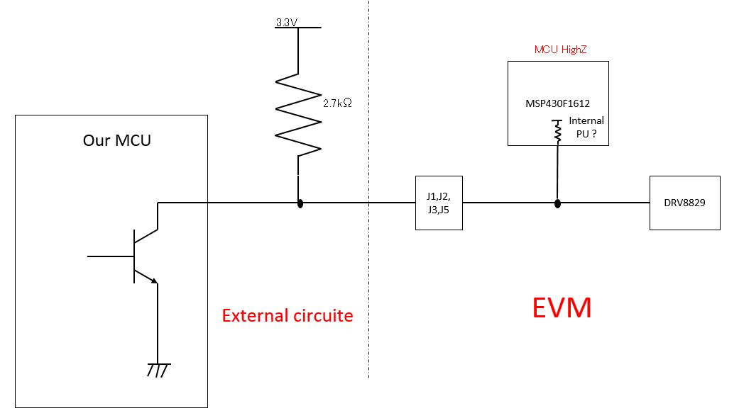

       However, I'll try connecting as bellow.
        Does MSP430 have internal Pull Up?
         Is there any problem with this connection?
    Sincerely.
    Kengo.
  • Kengo,
    If the MCU pull-up source voltage is not higher than MSP430 pin voltage rating and MSP430 is in Hi-Z mode, I don't see any issue.
  • Wang.
    MSP430 has internal pull down and pull down in the data sheet.
    It seems to remember the last command.
    If MSP is fixed Low, can I input an external signal?
    I am concerned that I can correctly communicate with the external MCU.
    Sincerely.
    Kengo.
  • Kengo,
    For test board or debugging board, you can force an external signal without worry about HiZ mode MSP430.

  • Kengo,
    I mean when MSP430 is in HiZ mode, those pins should have a high impedance. So, the external signal can be forced to any value without thinking about the MSP430's connection.
