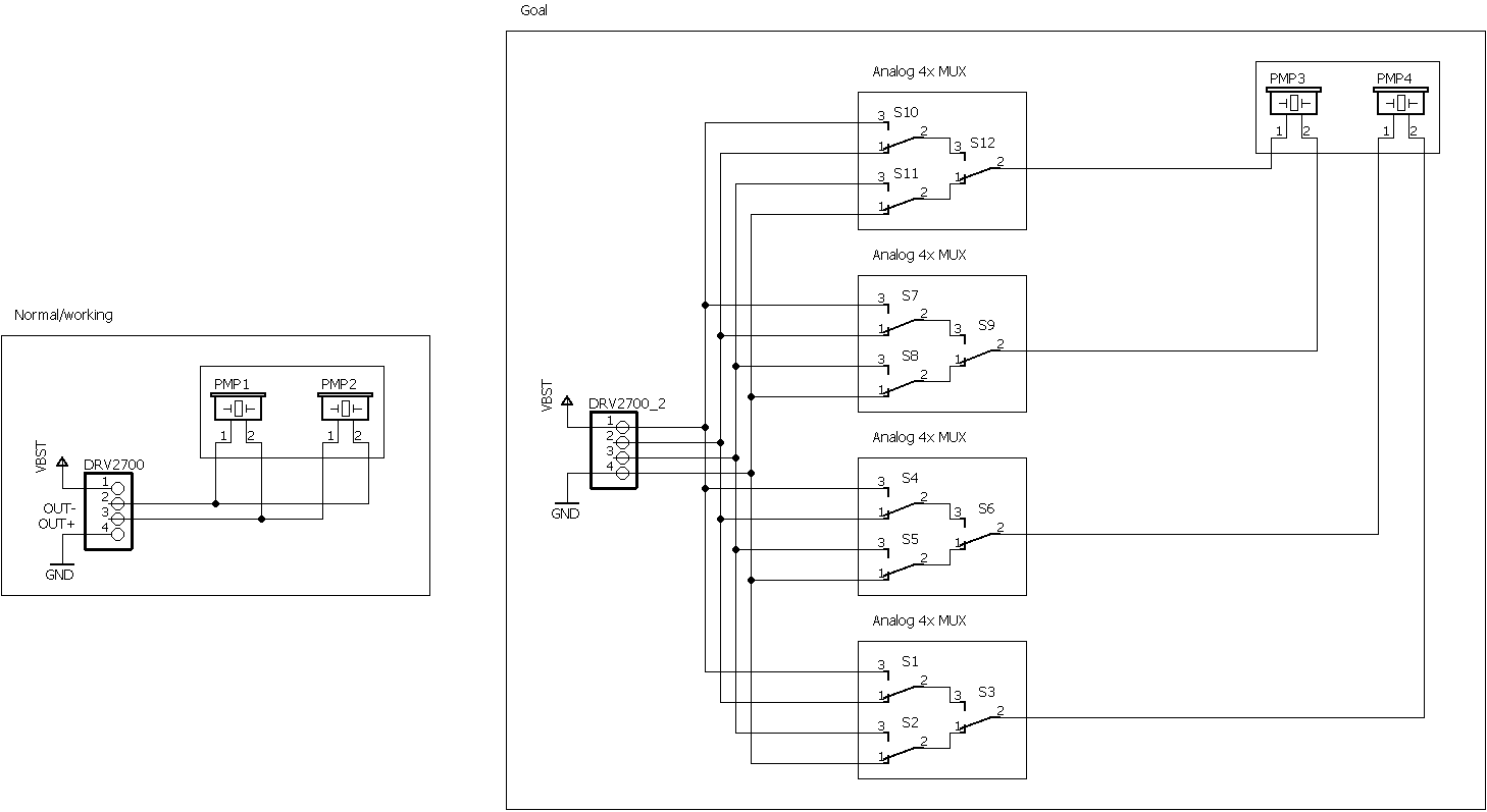

I am using the DRV2700 to drive a piezo pump that has 2 actuators (4 leads) by connecting the 2 actuators in reverse (compared to each other) to the DRV2700 output. The pump actuators are driven with a 1kHz sinus.
I would like to change the connection of the pump from reverse (+- vs -+) to same (both +-) to change the function of the pump to that of a valve. These changes do not have to be faster than 10Hz but at least 1 Hz.
Do you know of a possible solution using solid state?
David

  • Hi.
    I have made a diagram where the analog multiplexers are represented by switches. I would like this switching to be done by ICs. Maybe 1:3 a mux would be enough.
    VBST is the boost voltage of the DRV 2700. OUT + and OUT- the output to drive
    David

  • Hello.
    Thank you for your reply.
    The connection to VBST - and also to GND - is only required if I want to use one DRV2700 to drive two piezo pumps where only one is active at any time (one to pump in and one to pump out). Setting the inactive pump to VBST would have it act like a closed valve.
    Using two DRV2700 for the two pumps, less switching would be required: each pump lead would require switch selection between OUT+ and OUT- and the rest could be done via the DRV2700 inputs.
    The only feasible way I found to switch the DRV2700 output would be solid state relays for up to 220V AC. With 4 terminals per pump at 2 pumps needing at least 2 switches that would amount to 16 relay switches, which is a bit much.
    Using one DRV2700 per each pump actor (4 in total) would also be a solution.
    What I would like to find out is, if there might be cheaper option with smaller footprint based on a high voltage multiplexer. Or maybe another solution I did not thing about yet.
    Thank you for your help,
    best regards,
    David
  • Hi, David,
    Sorry, I couldn't find any other solution that could fit your application like the DRV2700 and the array that you mentioned. There are other piezo drivers in our Haptics Portfolio ( http://www.ti.com/motor-drivers/actuator-drivers/products.html#p2126=Piezo ), but its output is not as high as the one of the DRV2700. For additional details about the rest of our products, please take a look at the Haptics Portfolio link.
    Please let me know if you have additional questions or comments on this.
