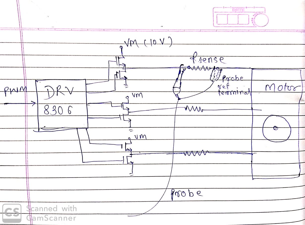

DRV8306: Charge Pump Failure
Part Number: DRV8306
I'm using DRV8306 in my motor control application. I am facing issue during measurement of voltage across inline sense resistor. When I connect the reference terminal of probe to switch node, charge pump fails and driver enters into fault mode.This results into permanent failure of charge pump and no further switching observed at CPL and CPH pins after this incident. I am interested to know reason behind this.
