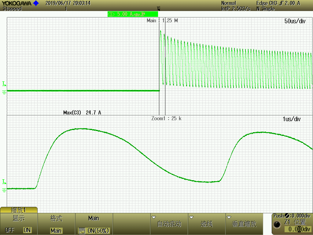

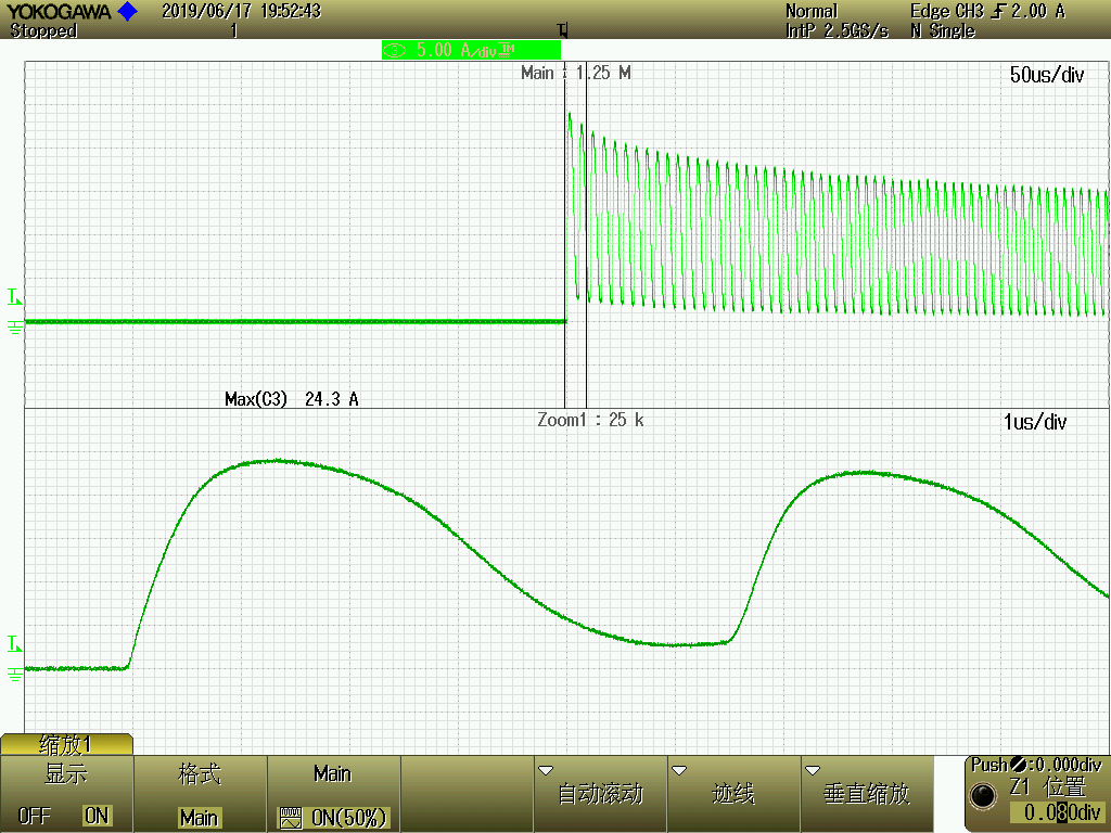

Customer reported IC failure when doing outputs direct short test on DRV8844.
DRV8844 is plugged to +/-24V power supply and drive 4 bi-directional solenoids.
>20A peak current was captured from current waveform. IC was damaged. OCP not triggered.
Is there analog current limitation to avoid IC damage from inrush current?
Other than limit the current from power supply, any other suggestion we may offer to avoid failures?

    3) Would you please confirm the grid in images 2 and 3? Do 10 minor vertical grids make up the 50us/div and 1us/div?  For example, does the current in image 2 reach ~24A in ~1.6us? in the 1us/div zoom in?

    2. The test was done with DC input, no PWM signal. The test was done in this way: 1. Disable DRV8844 by setting ENx=0, and shorting corresponding OUTx to GND; 2. Enabling DRV8844 with INx=1 (for shorting to +24V testing) or INx=0 (for shorting to -24V testing). The device can survive if INx=0 (shorting to -24V, since VM=+24V, VNEG=-24V), FAULT signal triggered properly. While the device was burned if INx=1, without any FAULT signaling.
    3. During shorting condition, the voltage on VM pin (+24v) and V3P3OUT (3.3v) kept fairly stable in spite of OUT current dramatically fluctuated between 0 and 24A.
    4. FAULT output always high until the part was destroyed.
    5. About the grid in images 2 and 3: 5 minor vertical grids make up 1us (1us/div, each div includes 5 minor grids).

    What is causing the current to decrease and increase as shown?
    This could be a contributing factor because the OCP deglitch time (Tocp) may not be met.
    If the OCP deglitch time is not met, the outputs will continue as shown.

    I don’t know. But surely it’s not due to the load, which is a simply wire connecting OUT to GND. Also we cannot due the reason to power supply, which is very stable during shorting test. Also, through the image I sent you can find, the time for output current exceeding OCP threshold has significantly longer than deglitch time. It is almost 8us for Iout >5A.

    Thank you for the additional information. I cannot explain why the current is decreasing then increasing as shown when the output is shorted to GND. I will discuss this with the design team.
    OCP may not assert at 5A. Per the datasheet, 5A is a typical value. OCP could assert as low as 3A, or higher than 5A.
    When an OCP event occurs, the current is expected to be consistently higher than the OCP trip level. The current oscillation is not expected.

  • Hi Alvin,
    We will send some additional information, but it appears the LGND is bouncing in the case above.
    This could cause ENx to change from a logic high to a logic low, disabling the output. When the output is disabled, the current decreases and ENx is seen as a logic high again. The cycle repeats until the device is damaged.
