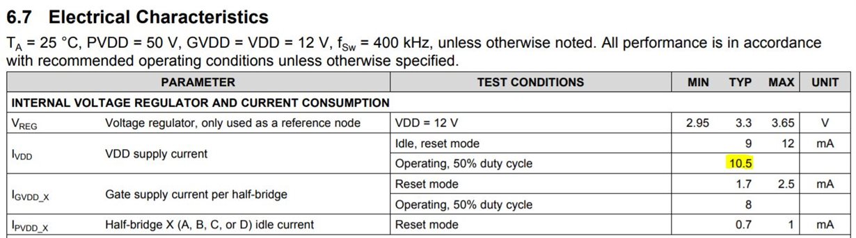

As indicated in yellow, will IVDD increase with increasing duty cycle? Thank you.

The IVDD should not increase with increasing duty cycle.
