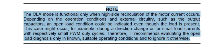

Hi Team,
I have a question about DRV8873H OLP.
DRV8873H Data sheet p.26 NOTE
Although
"Therefore, TI recommends evaluating the open load diagnosis only in known, suitable operating conditions and to ignore it otherwise."
is described here, specifically, in what way are you ignoring Other than open load?
Customers say that OLP is detected even when the motor is connected, and accurate open detection can not be performed.

  • Hi Ishiwata-san,
    How is the customer testing OLP? Is the DRV8873H detecting an OLP or OLA?
    Is there enough current in the load to create a 450mV voltage (Vola) across one of the high side body diodes?
    The OLP test is performed:
    1)  at power-up when the nSLEEP pin is set to a logic high or
    2) when the nSLEEP pin transitions from a logic low to a logic high.
    OLA may not operate properly at low currents.
    OLA does not operate properly during low side recirculation.
  • Ishiwata,
    "Customers say that OLP is detected even when the motor is connected"
    OLP is Open-Load Detection in Passive Mode. It is different than OLA. The note in your post is for OLA.
    For DRV8873H OLA, if low-side current recirculation is done with independent PWM control, an open load condition is detected even though the load is connected. To avoid this false trip, the OLD must be disabled by taking the nOL pin high.
    Since we are talking about Hardware version of DRV8873, OLA can also pull down the nFault pin which makes that customer think OLP doesn't work. So, can you keep all FETs and check OLP status?

  • Hi Ishiwata-san,
    How is the motor connected to the DRV8873H?
    Is a single motor connected across OUT1 and OUT2?
    When the device exits sleep does nFAULT assert? If so, this is OLP.
    Is the fault asserting as the motor is being driven? This is OLA.  If so, please provide scope captures of the inputs and outputs. This could be a case where the current is too low to create a voltage greater than Vola when PWM'ing.
    If the problem is an OLA fault, a compromise is to perform OLP when the DRV8873H exits sleep. If no fault the motor is connected. Then connect nOL to a logic high while running the motor.

  • Hi Ishiwata-san,
    Now that the customer has identified OLA is occurring, this could be a case where the current is too low to create a voltage greater than Vola when PWM'ing.
    Did the customer add schottky diodes from OUTx to VM? If so, please remove them.
    If there are no external components affecting the Vola, increasing the current should work. This is not optimal because an increase in power is required to determine there is a open load.
    As mentioned earlier, a compromise is to perform OLP when the DRV8873H exits sleep. If no fault the motor is connected. Then connect nOL to a logic high while running the motor. This method will check for an open load prior to running the motor. During operation, IPROPIx can be monitored for proper current.
