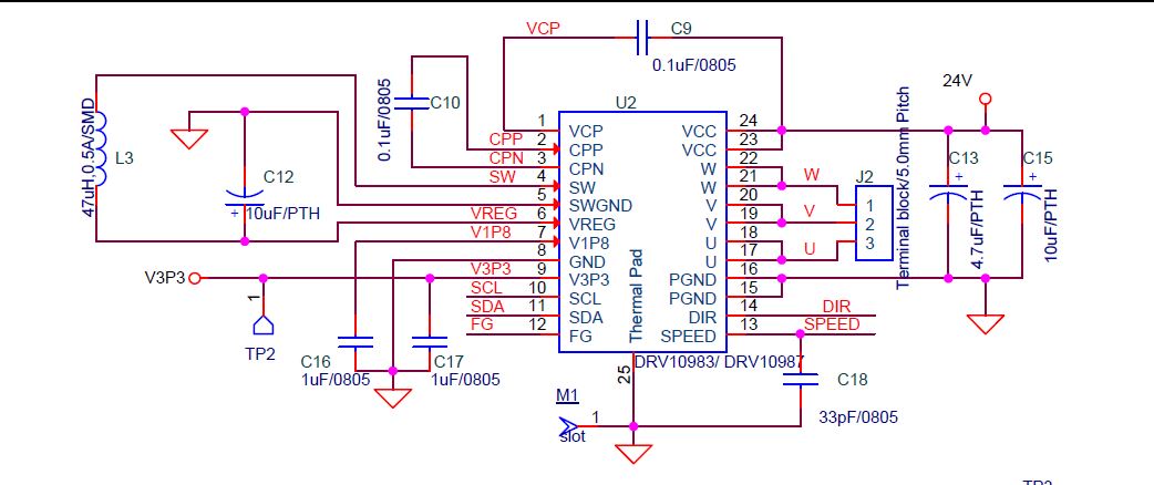

    Please find my schematic
  • 1) I compared your schematic with that of the recommended circuit, and these are the differences I see:
    a)  C1 is 100nF instead of 10nF (I dont think this is the issue)
    b) L3 has to have 1.15-A current rating and have dc resistance less than 1 ohm (check "table 36. external components" in datasheet). This might be an issue.
    2) What is the current draw fo the device when there is no motor? Is it as expected?
    3) Is there any differences in the boards between DRV10987 and DRV10983, other than the actual IC?
    4) If you want me to explore this further, please take a waveform of the motor phase current during startup so I could get  a better idea of what is going on.
  • Thanks for your reply....
    a)  C1 is 100nF instead of 10nF (I dont think this is the issue)  --> Changed to 10nF problem still there.
    b) L3 has to have 1.15-A current rating and have dc resistance less than 1 ohm (check "table 36. external components" in datasheet). This might be an issue. --> L3 matches the SPECS
    2) What is the current draw fo the device when there is no motor? Is it as expected? -->Current drawing at without motor <10mA. (8.4mA) only
    3) Is there any differences in the boards between DRV10987 and DRV10983, other than the actual IC?  -->No difference. I am using same board for both the part numbers.

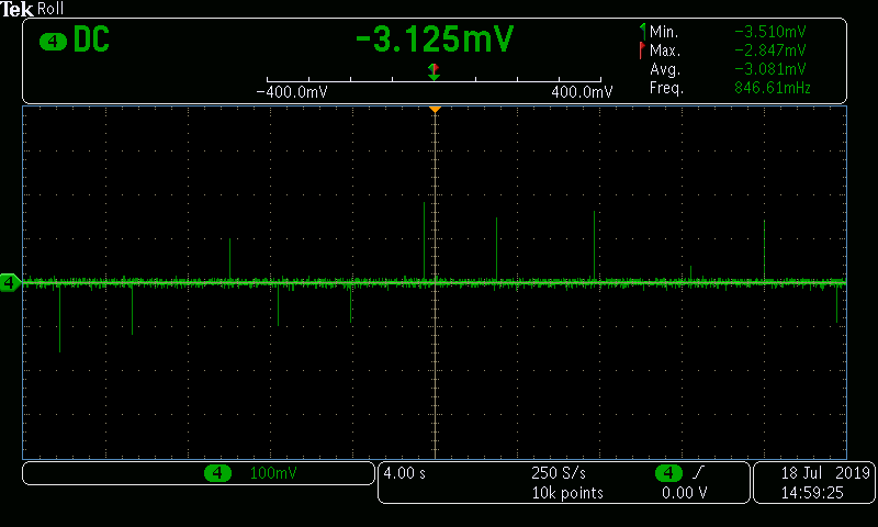

    4) If you want me to explore this further, please take a waveform of the motor phase current during startup so I could get  a better idea of what is going on. Please find it below:-
    Current  Probe Waveform. 100mv/1A . At 24VCC of the DRV Chip.
    Any possibility to run the Motor dependent on input current.
     For a example:-
    1. if input current limit is 0.5A means Speed of the motor is 25%.
    2. if input current limit is 1.0A means Speed of the motor is 50%.
    2. if input current limit is 1.5A means Speed of the motor is 75%
    Without any external sensing the DRV need to self-Run.

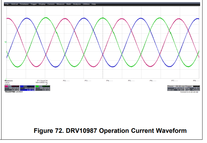

  • 1) I am confused by the current waveform because usually, I would expect motor phase current to look sinusoidal like below:
    2) You can use the software current limit to limit duty cycle based on current.
