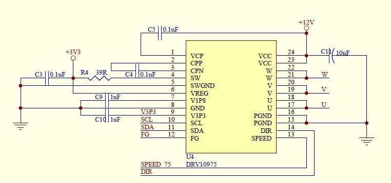

What kind of issue may cause eeWrite fail of DRV10975?
I use DRV10975 EVM GUI to set value for register of DRV10975.
As the following figure is the schematic.
I change the voltage from +12V to +24V when I am doing eeWrite.

  • 1) For C3 in your schematic, the typical application schematic in the datasheet shows it should be a 10uF. I need to check if this is important, but this could be the issue.
    2) If you are using a sleep mode device, and the device is in sleep, I2C communication will not work unless you exit sleep. Refer to "Table 1. Conditions to Enter or Exit Sleep or Standby Condition".
    3) Also make sure you have a pullup on the SCL SDA lines
    1) For C3 in the schematic, I will try 10uF. Please let me know if the capacitance is an important issue.

  • 1) What specifically is indicating that i2c write is failing for you?
    Are you able to send read commands?
    2) Please follow the steps in sections 8.3.5 Non-Volatile Memory and 8.5.1 I 2C Serial Interface . Programming eeprom may fail for example if you dont program to the correct slave address or the eeprom wont be burned if you dont write (0xB6) to enProgKey in the DevCtrl register.

  • 1) I think you said you were using the DRV10975 gui. You are using the DRV10975 gui with the evm or with a custom board?
    2) I want to confirm which part of i2c communication are working and not working.
    a) Are you able to i2c read?
    b) are you able to write the enProgKey in the DevCtrl register, and then read it to check if the write is successful?
    c) Is the only i2c fail behavior that the you are not able to burn the eeprom with permanent settings, even after power on and off?
    3) As mentioned previously, please follow the steps in sections 8.3.5 Non-Volatile Memory and 8.5.1 I 2C Serial Interface . There are many steps that if you dont follow, wont allow programming to be successful.
    4) When the device is on and you write to different registers, you are actually only accessing the shadow eeprom registers, and these arent permanent. They only become permanent (permanent meaning the settings wont go away when power off and on) when you follow the procedure in 8.3.5 Non-Volatile Memory
