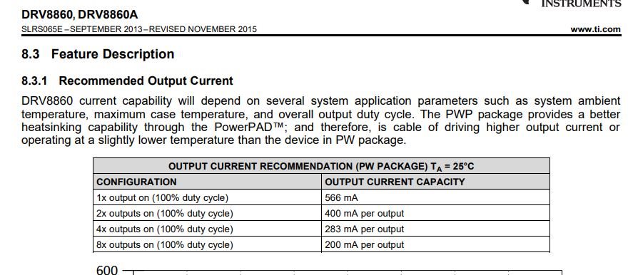

I'm wondering if i have two channel needed 300mA, one channel needed 400mA, could DRV8860 support this?
The datasheet only describe the N=1,2,4,8.

Hello James,
Yes, it could be possible. You just need to parallel some of the outputs to each load. My suggestion would be to configure two outputs in parallel with one of the 300mA load, another two outputs in parallel with the other 300mA load, and the remaining four outputs connected in parallel with the 400mA load.
