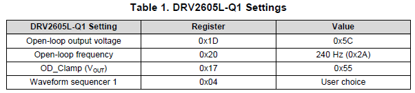

  5. In addition to below settings, are there any specific settings of DRV2605L-Q1 for the input of DRV2700?
      6.   Do you have an example code?
Sam Lee
  • Hi, Sam,
    1.- In order to use the internal libraries with the DRV2700, the DRV2605L-Q1 would need to be configured in open-loop mode. All the configurations that involve an output feedback (closed-loop, auto-calibration) cannot be used in this case since the load would not be an LRA or ERM (which are the only loads supported by the DRV2605L-Q1). Open-loop mode offers the possibility to adjust the output voltage and the frequency (if required). In that case, the DRV2605L-Q1 could output a signal from the libraries in PWM format.
    Then, the output would need to be connected through an RC filter to the DRV2700 as shown in the figure 33 of datasheet ( http://www.ti.com/lit/ds/symlink/drv2700.pdf#page=21 ).
    However, this is not a common usage of the haptics drivers and we would recommend to use another PWM source instead of the DRV2605-L.
    2.- Could you contact me via email in order to provide the details of the ROM library?
    3.- Once the GO bit is enabled, the DRV2605L-Q1 may generate up to 8 waveforms in sequential playback. The GO bit will be disabled once the sequence finishes. So, the user would need to send GO commands constantly for a constant waveforms generation.
    4.- All the registers sequence is correct except the lines that involve the auto-calibration. As I mentioned, it could result in an error since the load won't be an ERM or LRA. The open-loop would be needed.
    5.- You may take a look at the example below for details about the effect generation in open-loop mode.
