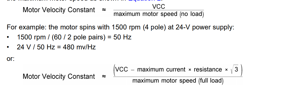

  • Hi Team,
    Please kindly help to provide a formula for calculating the Kt value. Customer tried the formula in the document, but it doesn't work.
    Whether the Kt value is the only certain value?
    Whether the resistance value is the resistance between any two phases divided by 2?
    Thanks.
  • I'm assuming you used the equation below:
    You can also try to measure kt by manually spinning the motor quickly or coast it, and use an oscilloscope to capture the differential voltage
    waveform between any two phases, as detailed in the tuning guide.
    You can guess if the kt is correct by looking at the BEMF constant Kt measurement in the display tab of the gui and seeing if it roughly matches what you ented.
    The resistance entered is the resistance between any two phases divided by 2.
