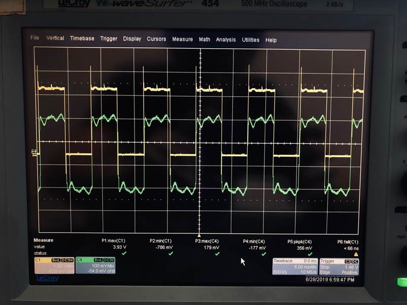

Customer studying DRV8835 and set it up to drive a stepper motor by using full-step.

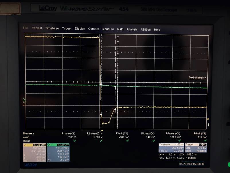

The waveform shows the overshoot and undershoot at the output is apparently large (-800mV) around 155ns.
Do you have any idea to reduce undershoot/ overshoot in application? But remain full-step driving due to torque consideration.
