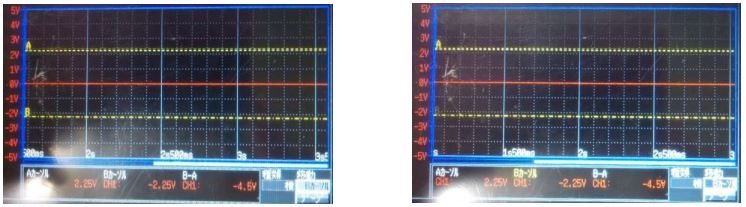

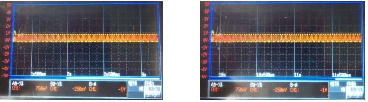

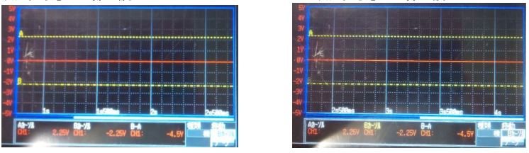

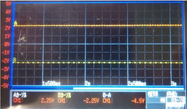

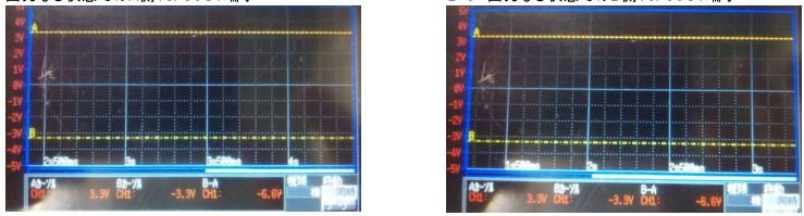

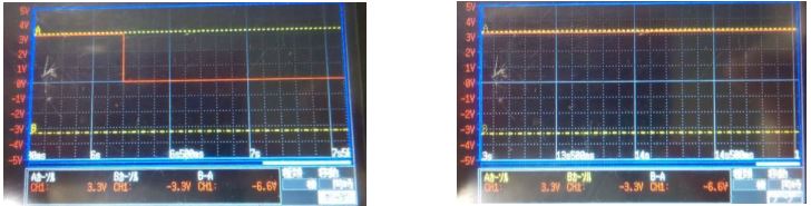

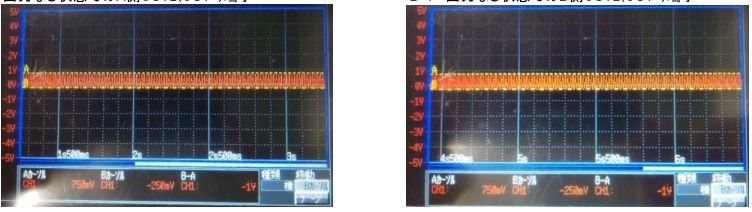

  • Hi Rick-san.
    I got some wave form.
    Could you check our phenomenon.
    All images are A on the left and B on the right.
    Then all are the waveforms when driving.
    *A is disabled because it is faulted.
    nFAULT
    V3P3OUT
    VREF
    The input is the same.
    ENABLE
    PHASE
    OUT1
    OUT2
    Sincerely.
    Kengo.
  • Hi Kengo-san,
    This points to an overcurrent.
    If possible, please provide a scope capture of the current of A just prior to the nFAULT occurring.
    Can the customer switch the outputs from A to B and B to A?
    If so, does the fault move to the B device? This could indicate a problem with the load or a difference in the overcurrent operation of the two devices.

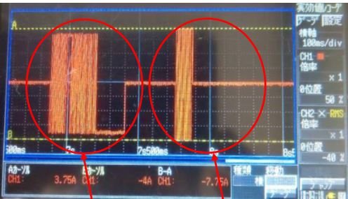

  • Hi RIck-san.
    We measured what you said.
    ''Can the customer switch the outputs from A to B and B to A?''
      -> The results is not change. The same driver has become OCP.
    As you say, I think the OCPs of the two devices are different.
    But, according to the data sheet, the OCP is 6A(min to max).
    Does this mean that there is no variation?
    This is the current wabeform that does not output.
    The output will be no output(OCP) in the second waveform.
    Sincerely.
    Kengo.
  • Hi Kengo-san,
    That is a mistake. The 6A minimum is correct, but there should be no maximum stated.
    If the current is above 6A for more than 3.75us (typical), the overcurrent could occur. Device to device variation (Iocp level or tblank) may allow one device to continue to operate while the other does not.
    To confirm this is an OCP event, please zoom in (5us/div) on the nFAULT event to measure the current prior to the event. If the current is >6A for ~3.75us, this is probably an OCP event.
    If the current is <6A, another possibility is one of the two outputs pins is not connected to the PCB.

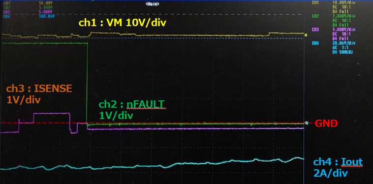

  • Hi Rick-san.
    I'm sorry for delay reply.
    I got a waveform about this issue.
    Could you check it?
    Please let me know, If you have any something wrong.

  • Hi Kengo-san,
    Sorry for the delay.
    I do not have a good explanation for the behavior. As you noted, OCP is the most likely reason but the current appears to be below the threshold.
    It is possible there is some damage either on the EVM or the device causing this.
    Do you have another EVM to try?
