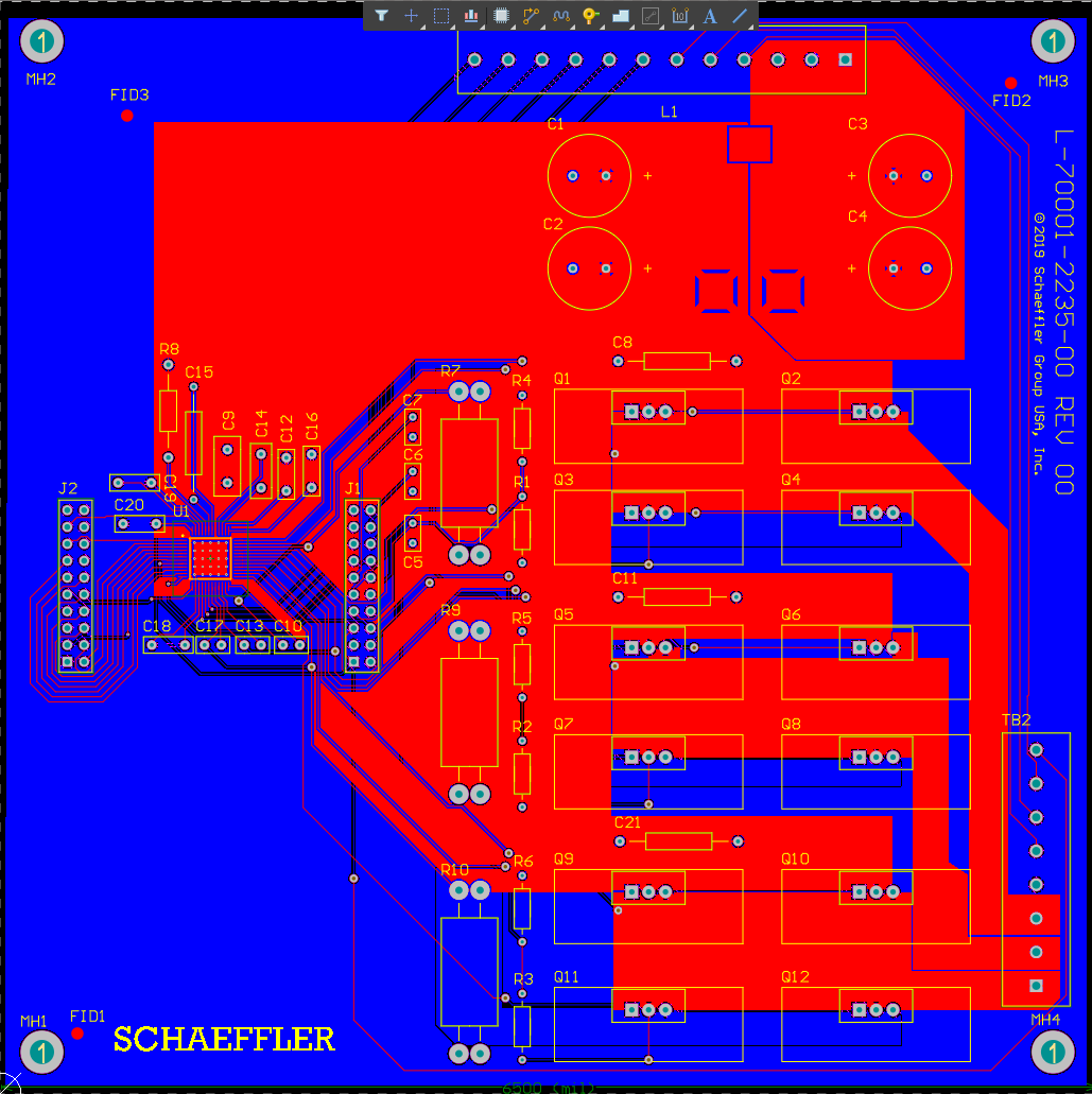

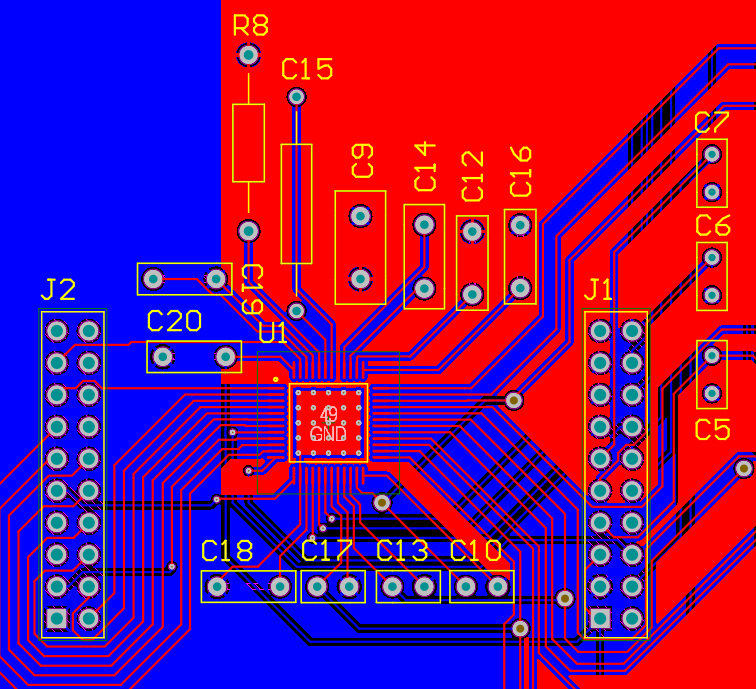

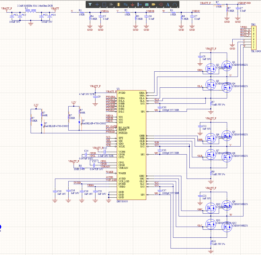

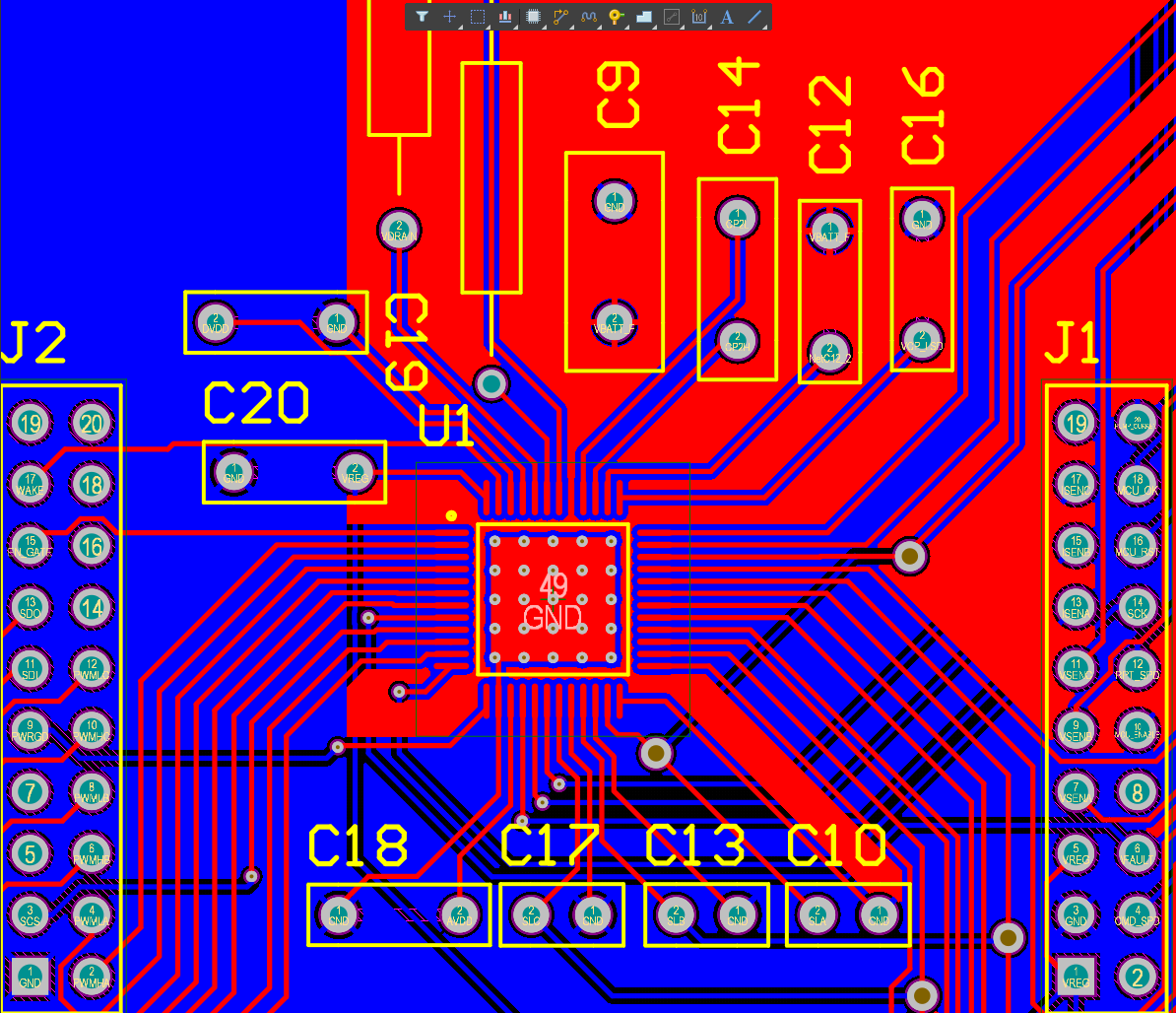

    Hi Adam,
    We removed the blown DRV chip, cleaned up the pads, and soldered a replacement part. (thank you TI for samples!), however the replacement part failed after some use, too (AVDD reads 0V).  I have attached the schematic for the PCB as well as some selections from the PCB layout.
    Notes:
    0. PVDD for testing has been set at 13.7V.
    1. The PCB is designed to mate with a Launchpad TMS320F28069M for development.  I have a 3.3V buck converter to power the launchpad board as well as the pullup resistors for PWRGD and nFAULT.
    2. At the moment half of the power MOSFETs (Q2, Q4, Q6, & Q8) are not present on the board.
    3. I failed to include the pullup resistors for PWRGD and nFAULT as well as the VSEN_PVDD voltage divider on the PCB.  I built these parts of the system (matching the DRV8305EVM design for PWRGD and nFAULT) on a prototyping board and am confident that they are wired up correctly.
    4. Because of the design error for VSEN_PVDD, I broke off the pins connecting VREG from the driver board to the Launchpad board.
    5. There is a strong chance that all 16V-rated capacitors were replaced with 25V capacitors with the same capacitance values.

  • Hi Adam,
    I am redesigning the driver board to add some of the boosterpack features such as 3.3V regulated power supply and transient voltage suppression as well as include the omitted VSENSE_PVDD voltage divider and the PWRGD and nFAULT pullups.
    One of the applications for this driver board includes a motor which requires 5V (~2.5mA) for its hall effect sensors (required for some non-TI microcontroller which is working at the moment with an 8305N boosterpack).  For this reason we are going to use the 83055 variant.  However I am concerned that using the 83055 driver may change the arithmetic for the current sense amplifiers and maybe something else on the board.  I'll likely have more to say tomorrow.
