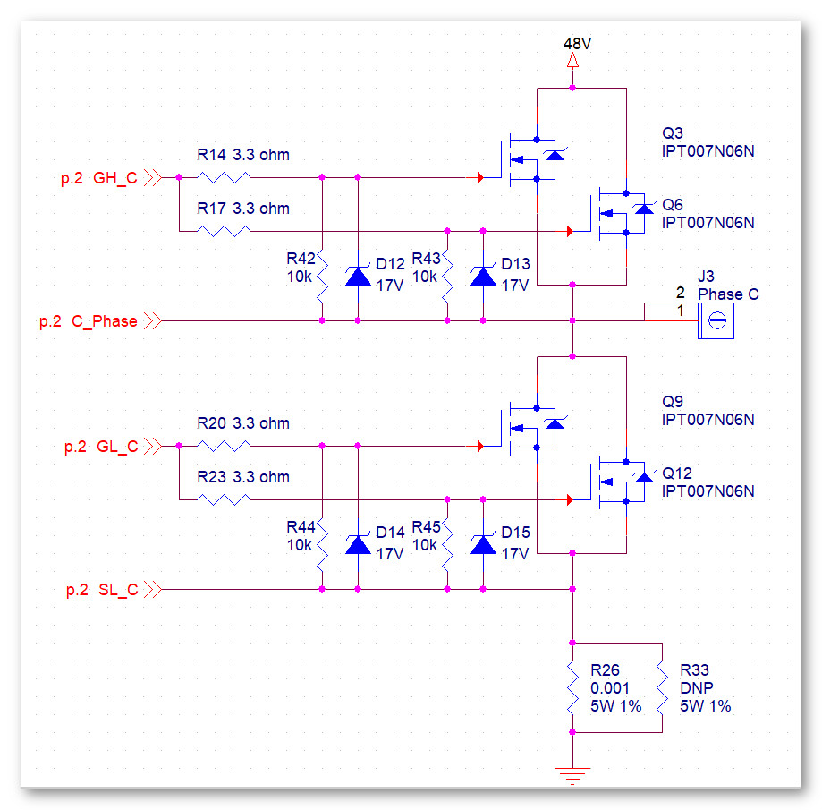

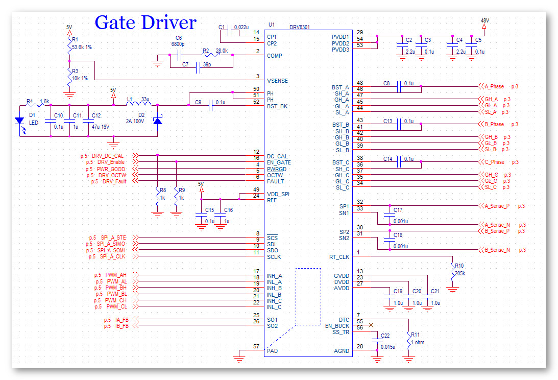

Here's the parts of the schematic that matter:
  • Also, I did remove the parallel FET and the gate protection passives (resistor, zener) to make sure that wasn't doing something awkward.  Didn't help.

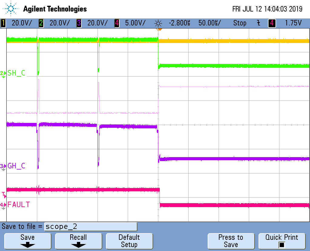

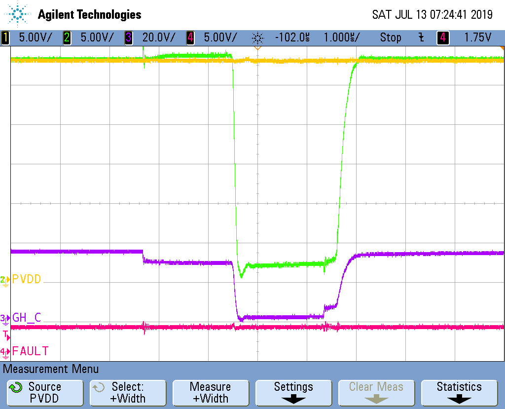

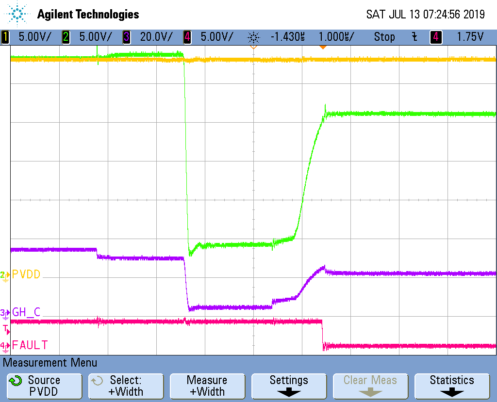

  • A few scope shots.  I put the probes right on the DRV8301 pin for that signal.
    1. Yellow: PVDD ( ~ 28V)
    2. Green: SH_C signal from high-side FET source pin
    3. Purple: GH_C (gate drive signal)
    4. Red: nFault signal (when this goes low, the FETHC_OC flag also get set in the status register, confirmed in debugger
    Pic 1:  After several pulses, fault triggered.
    Pic 2:  Zoom of a non-offending pulse
    Pic 3:  Zoom of the pulse that triggered the fault.
  • Andrew,
    It looks like your issue is that you're operating at almost 100% duty cycle which is tough for a Bootstrap architecture. The BST cap is not being refreshed enough (this happens when the SHx is low) and the HS gate is struggling. This is not allowing the HS FET to fully turn on which is triggering a VDS fault.
    Can you adjust something so that you don't have to operate at 100%?
    Regards.
    -Adam

  • RESOLVED!  (well, I get to continue debugging the board)
    Adam was correct, the duty cycle was too low to service the boost regulators, causing the high-side FETs to fail to turn on, which then triggered the Vds overcurrent check by the driver.
    I had to ensure the PWM duty cycle never got below about 5%.  2% was too little.
