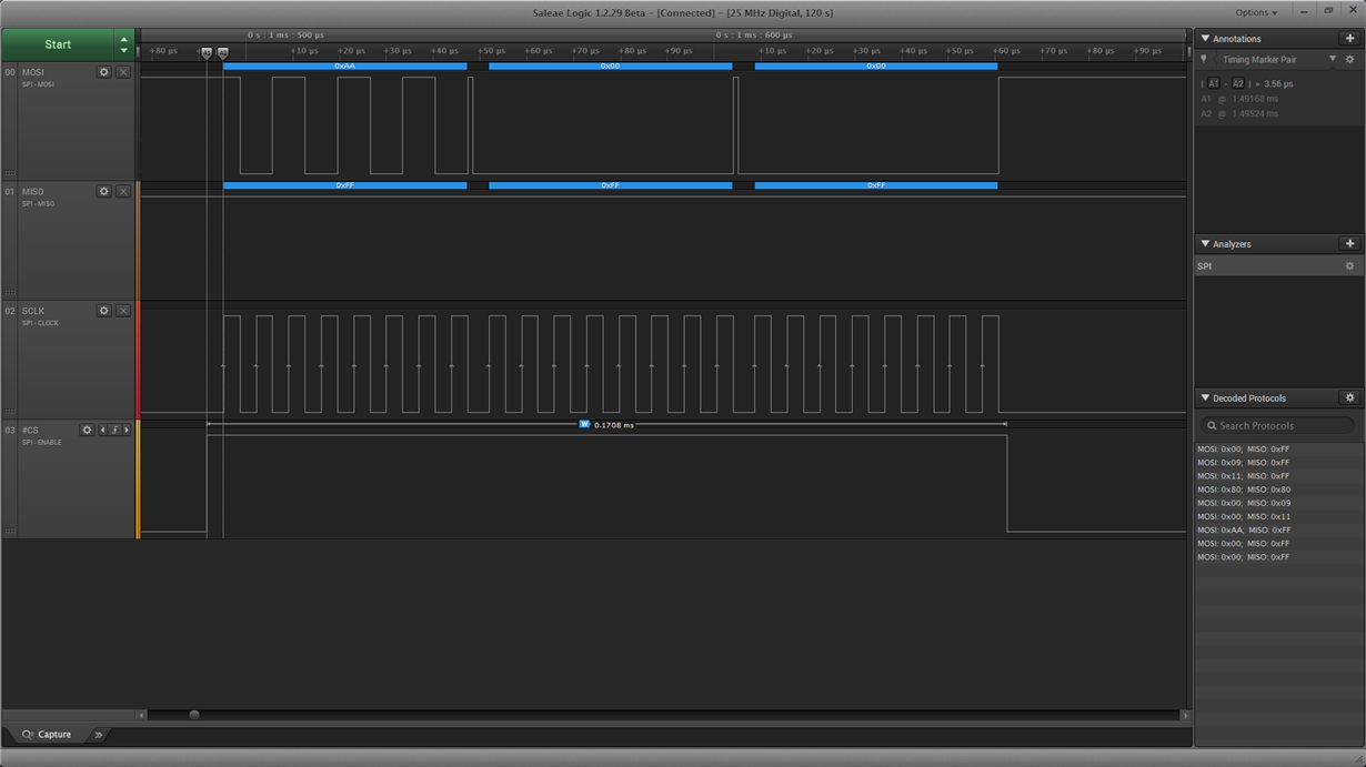

I am trying to use the drv8308 on our current project.
I am able to write/read register 0x00 of the chip.
When I try to read any of the other registers, I am reading 0xFFFF back from them (0x01 to 0x2A).
My SPI Speed is 288 KHZ.
My MISO Line has a pull-up resistor.
When I write and read register 0x00, all of the lines are nice and clean (0 to 5 volt signals) according to the scope and logic analyzer.
I have tried reading register 0x2a (Fault register). but all I get back is 0xFFFF. This is the same with all of the registers. All of the other SPI devices on the my SPI bus work perfectly.
I am definitely meeting all of the timing requirements according to the data sheet.
I have also looked at the threads where they are having issues with SPI.
Any thoughts as to why this is happening?

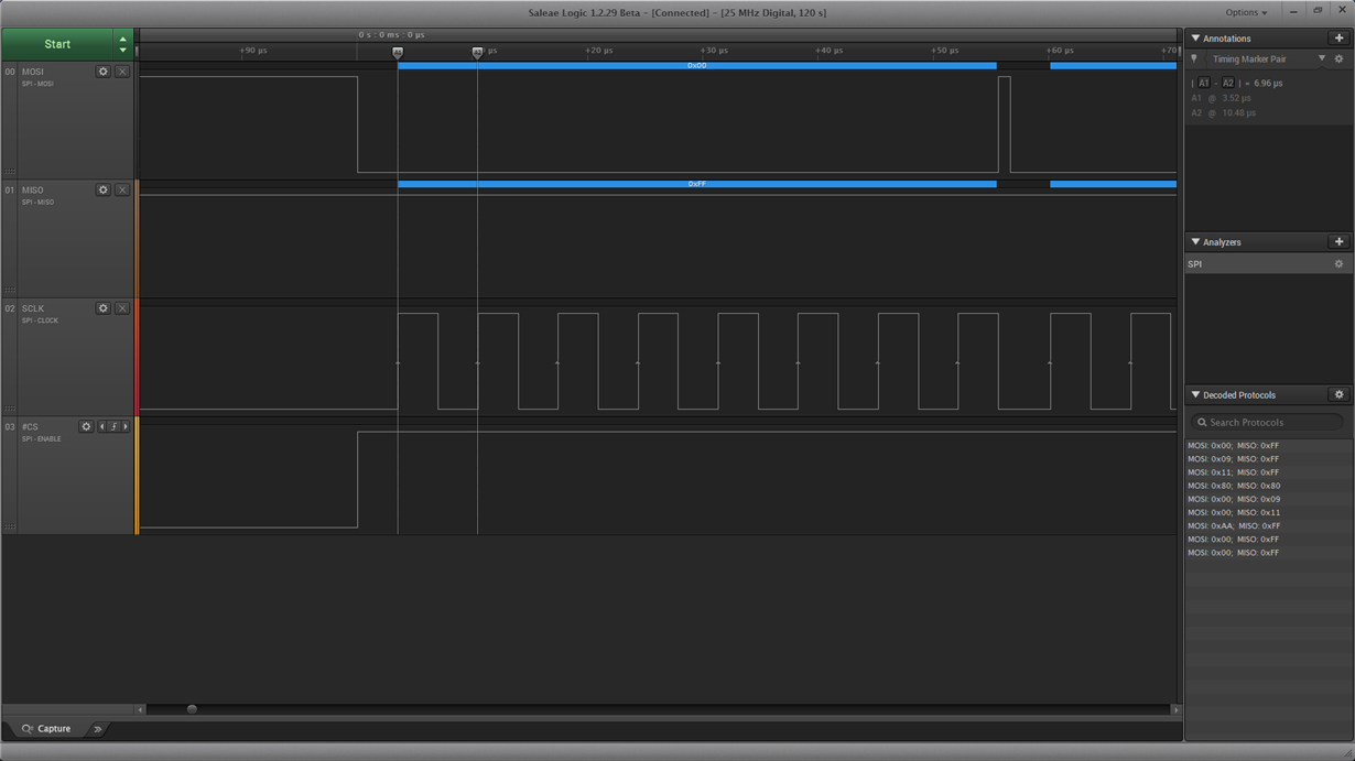

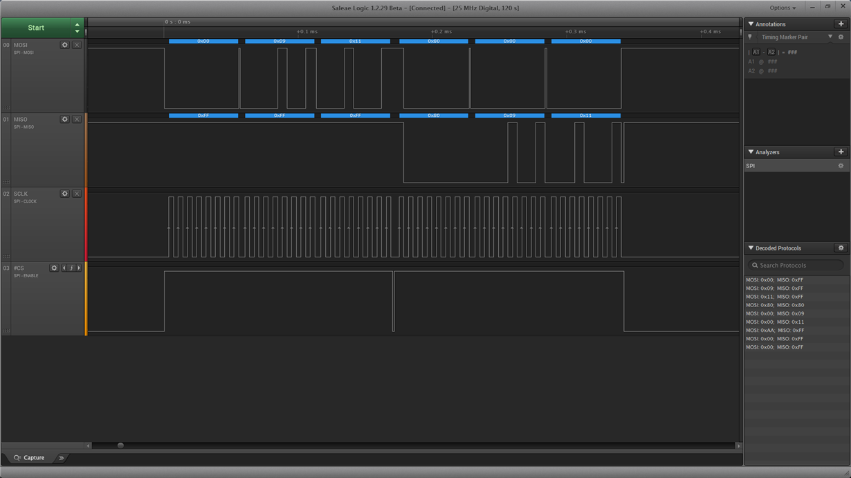

  • Adam,
    Here are the analyzer traces of the SPI transactions.
    The first two traces show the time from CS High to SCLK is 3.52 micro seconds and SPI SCLK period is 6.96 micro seconds. They also show the write and read of register 0x00. The Read of register 0x00 is obviously good.
    The last two traces show the read value of the FAULT Register 0x2A is 0xFFF.
    I can make a scope trace of this if you like.
    Thanks Adam,
    Reif

  • Hi Adam,
    I am finally able to read the Fault Register 2A as 0x18.
    One thing I found is if the ENPOL bit is not set first in register 0x00, all other registers read as 0xFFFF.
    Also, the board manufacturer left RESET floating. Is that an issue? Should it be grounded instead of floating?
    Thanks for your help,
    Reif

  • Reif,
    Sorry, E2E is not meant for real-time communication, there are delays.
    RESET has an internal pull-down so no need to do anything to it unless you want to pull it high and reset the device.
    Yes the device must be enabled for readback to work. How is your ENABLE pin connected?
    -Adam

  • Hi Adam,
    The RESET Line GPIO connection to the processor was set up incorrectly. It was configured as an unused GPIO pin. Unused GPIO Pins on the ATMEGA 2560 are supposed to set as inputs and internal pull ups are enabled. I set the Pin up as an output and now its right as rain (technically speaking).
    Thank you for your help.
    This can now be marked as resolved.
