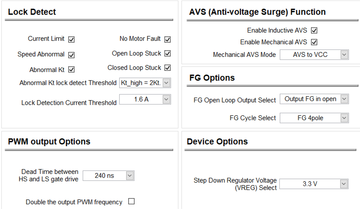

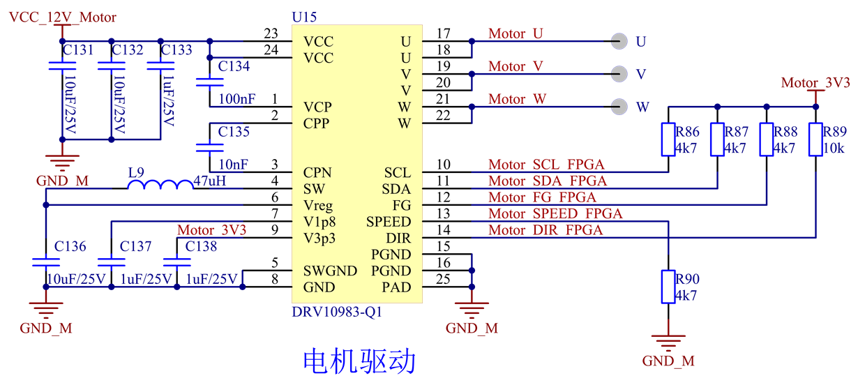

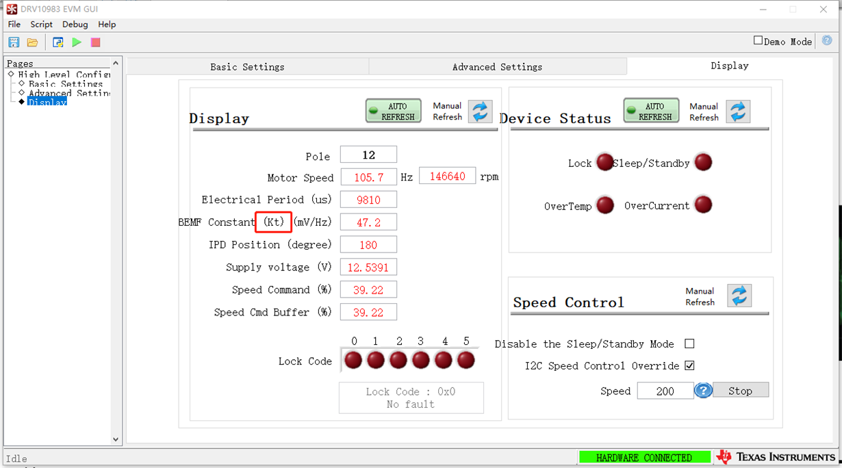

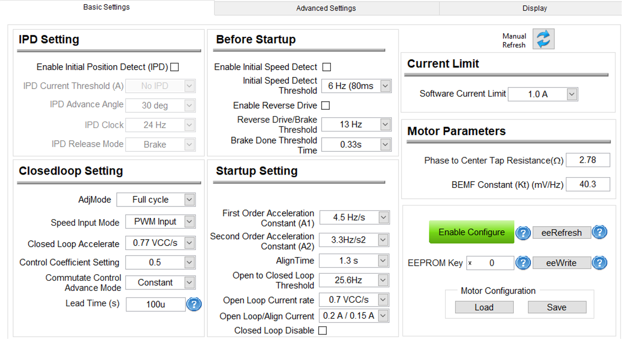

DRV10983EVM: n closed - loop control, it is easy to jam.Drive current is too small for only 20mA. How to adjust parameters?
Part Number: DRV10983EVM
Other Parts Discussed in Thread: DRV10983, DRV10970
In case of failure, observe DRV10983 register 0x10, starting from 0x0f-> 0x1f, and register 0x1e changes from 0x00 to 0x04/0x02/0x01 according to different rotation speed (5Hz/10Hz/20Hz).
At low speeds, failures are more likely to occur.
