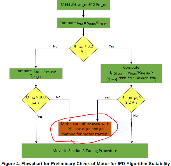

Hi everyone,
Please let me know the IPD.
If the condition is not in the red frame below, will IPD always succeed?
What is the time for the motor to start when using IPD?
1) The flow chart is a guideline, not a guarantee. But we dont have any current big customer issues with IPD.
2) It depends on the IPD Clock setting. Time it takes for IPD = 6 pulses at IPD frequency. So if IPD Clock is set to max 95Hz, then IPD duration = about 6 pulses * 1/95Hz = at least 63ms.
