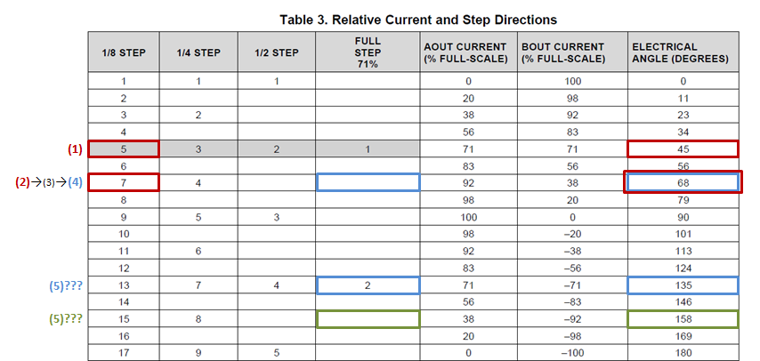

 Hello supporting team,
This is Ochi. I would like to know change of electrical angle during disable mode (nSLEEP = 1, DRVOFF = 1). Could you tell me what happens in below situation?
(1) Making DRV8889-Q1 operating mode (nSLEEP = 1, DRVOFF = 0) with 1/8 step mode. Then, electrical angle is first position, 45 degrees.
(2) Next, attaching two step signals. Then, electrical angle is 68 degrees.
(3) Next, making DRV8889-Q1 disable mode (nSLEEP = 1, DRVOFF = 1) and changing the step mode to Full step 71% from 1/8 mode.
(4) Next,  making DRV8889-Q1 operating mode (nSLEEP = 1, DRVOFF = 0), Then, electrical angle is still 68 degrees. Is it correct?
(5) Next, attaching one step signal. Then, is electrical 135 degrees or 158 degrees? Also I would like to know why it happens.
Ochi
  • Ochi-san,
    It is correct. Also, STEP pin doesn't give any sign to make it move or reset to full step 71% setting.
    It is 135 degrees not 158 degrees. The STEP pin signal make the motor move.to next steps. The next step is defined by the micro-step setting.
