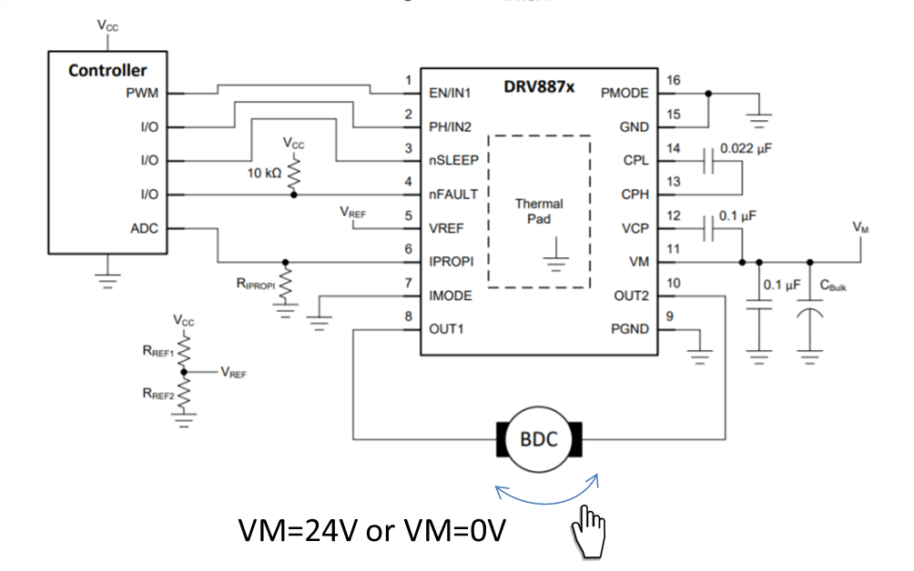

Regarding to BEMF of DRV8876, what is effective provision?
Can you suggest some ideas?

DRV8876 doesn't integrate the BEMF detection circuit. So, an external BEMF detection circuit is needed.
Please check this link to understand BEMF calculation and the external detection circuit.
https://www.precisionmicrodrives.com/content/ab-021-measuring-rpm-from-back-emf/

I want to protect IC from BEMF because the motor could be moved by external strength forced.
So measuring and detecting BEMF is not required, protection from BEMF is required.
I attached assumable situation.
Could it be possible to use DRV8876 even with such use case?
