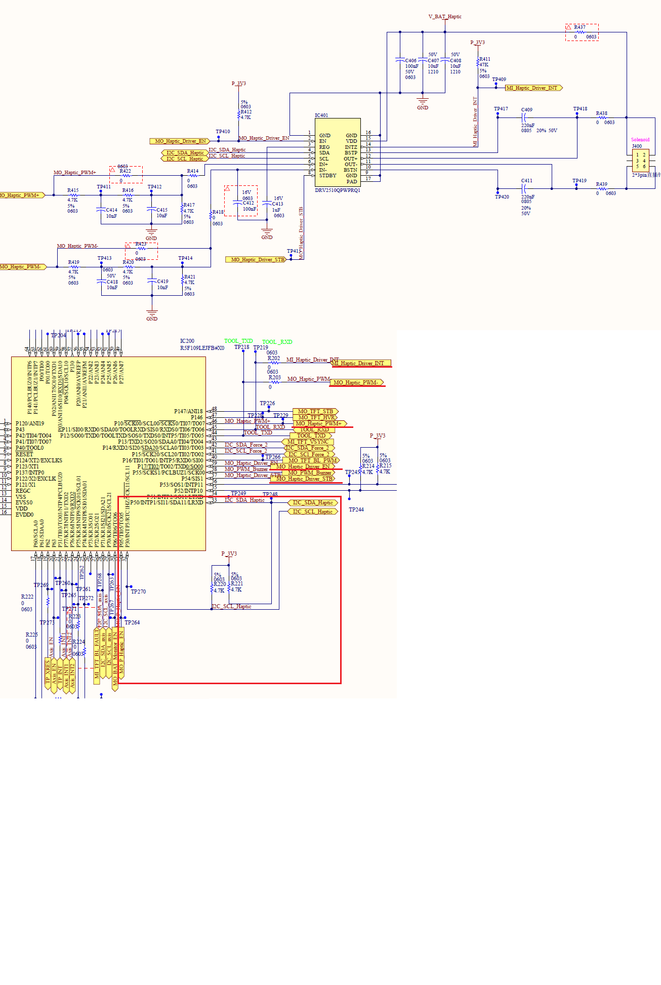

    MCU is R5F109LE,  pin 32, 33 I2C both with 4.7k pull up Res,   INT, EN  has 4.7k pull up, STB no pull.

    Thanks, today  tried 7-bit 0x6C and 2.2k pullup, still can't communicate. All IC power is 3.3V, no caps on I2C.

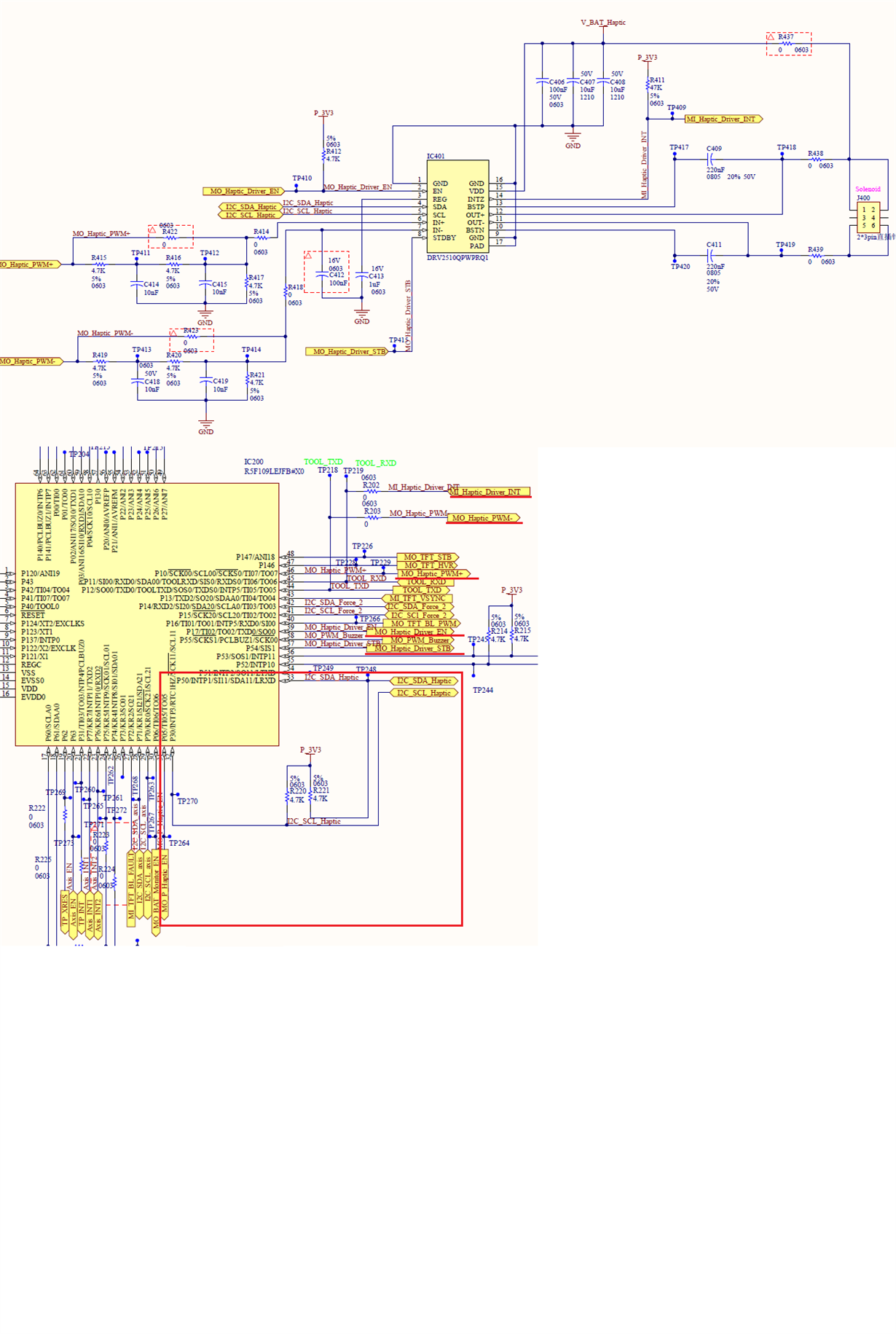

    The schematic as below.
    Thank you for providing the schematic circuit.
    Could you try increasing the EN pin pull-up resistor to 100K?

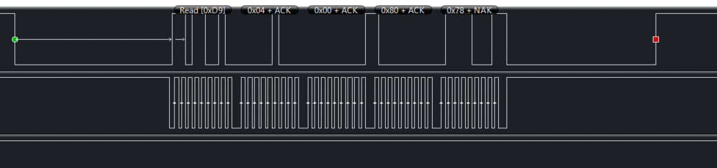

     When Power On , I Can Read The Drv2510 Data , The Frist Read Data is 0x04 0x00 0x80 0x78, And This Data Corresponding register address is 0x00-0x03
     But The I2C communication Read Data : The 0x04 0x00 0x80 The slave response Ack , And  The 0x78 Data The Slave Not response Ack(NAk); Here is NAK, not sure if it is a problem.

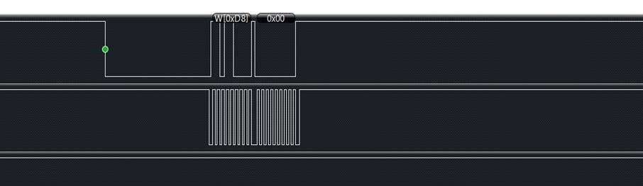

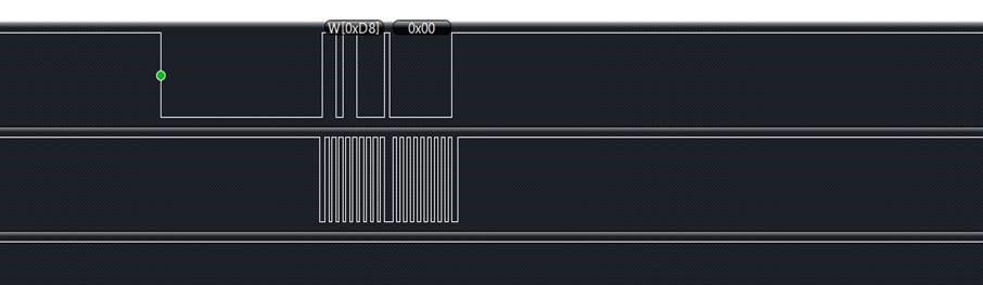

    Regarding the I2C capture that you attached (I2C Wave.png), I noticed that there is a write command for the register 0x00. The register 0x00 is Read-only type. If you omit this write command, do you have the same results? I mean, could you only read the registers from 0x00 to 0x03 or write register 0x03 only?
    In addition, I don't see the register address selection in the read command waveform. The read command must include a sub-address as shown in section 7.5.5:

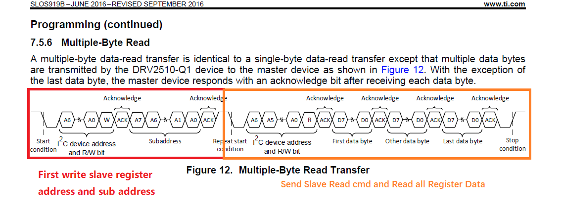

    When I Read Slave Alll Register Data,  Frist Send Slave Write Address Cmd And Subaddress ,Then Send Slave Read Address Cmd. Last Read All Register Data.
    Thank you for your information above.
    However, it seems that you are sending a write command for a multiple data reading.
    In order to perform a multiple data reading, you must send an I2C read command, then the subaddress. After this, you can perform a multiple-byte reading.
    Could you use a read command instead of the write command?

    My progress is : white cmd, white adr, read cmd, read adr.
    In detail, after The Power is On, MCU give EN low for 229ms, then give EN high level.  and Then MCU with Frist i2C communication , and the Slave can be response to MCU including ACK , then after 10 ms, MCU will second  I2C communication, but the slave can not be response.
    so, the question: Why MCU second I2c Communication , slave not response,
