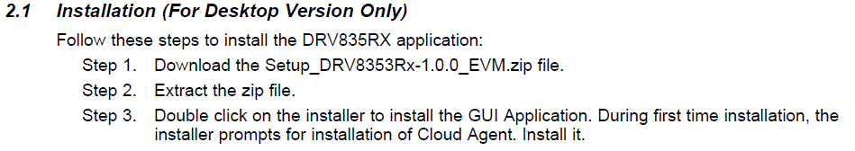

Regarding the DRV8353RS-EVM GUI, I have two questions:
1. Accroding to "DRV8353Rx-EVM GUI User’s Guide" chapter 2.1, the install file name is "Setup_DRV8353Rx-1.0.0_EVM.zip", but I can only find " DRV8353RS/H-EVM GUI (Rev. A) ". Is this file the EVM GUI described in user's guide ?

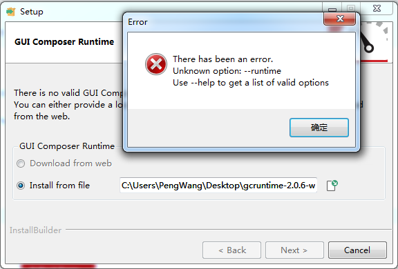

2. I tried to install  DRV8353RS/H-EVM GUI (Rev. A) , and encountered GUI composer runtime issue. Then I tried the method decribed in https://e2e.ti.com/support/motor-drivers/f/38/t/453557?pi320995=2#pi239031350=2, but following error occured:
How shound I solve this problem ?

    [17:32:14] download selected [download_gcr] 1
    [17:32:37] file selected [local_gcr] C:\Users\PengWang\Desktop\gcruntime-2.0.6-windows-installer.exe C:\Users\PengWang\Desktop\gcruntime-2.0.6-windows-installer.exe
    Executing C:\Users\PengWang\Desktop\gcruntime-2.0.6-windows-installer.exe --mode unattended --unattendedmodeui minimal --prefix "C:\ti" --runtime "C:\ti\guicomposer\runtime/gcruntime.v7"
    Script exit code: 1
    Script output:
     There has been an error.
    Unknown option: --runtime
    Use --help to get a list of valid options
    Script stderr:
     Program ended with an error exit code
    Error running C:\Users\PengWang\Desktop\gcruntime-2.0.6-windows-installer.exe --mode unattended --unattendedmodeui minimal --prefix "C:\ti" --runtime "C:\ti\guicomposer\runtime/gcruntime.v7": Program ended with an error exit code
    [17:32:45] Local gcr: C:\Users\PengWang\Desktop\gcruntime-2.0.6-windows-installer.exe
    [17:32:45] gcversion =
    [17:32:52] file selected [local_gcr] C:\Users\PengWang\Desktop\gcruntime-2.0.6-windows-installer.exe C:\Users\PengWang\Desktop\gcruntime-2.0.6-windows-installer.exe
    Script exit code: 1
    Script output:
    Script stderr:
    [17:32:59] Local gcr: C:\Users\PengWang\Desktop\gcruntime-2.0.6-windows-installer.exe
    [17:32:59] gcversion =
    Cannot delete file C:/Users/PengWang/AppData/Local/Temp/bitrock_installer.log
    Cannot delete file C:/Users/PengWang/AppData/Local/Temp/bitrock_installer_29940.log

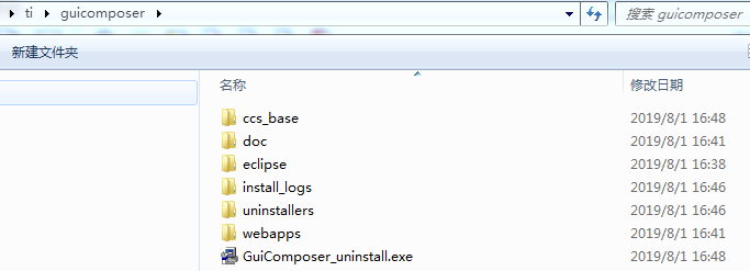

  • Peng,
    Please use this page to download the latest Gui Composer Runtime, I don't believe you are downloading the correct version currently.
    http://processors.wiki.ti.com/index.php/Category:GUI_Composer#GUI_Composer_Runtime
    -Adam
  • Hi Adam,
    I tried to install GUI Composer Runtime (CCS v6.1.1): Download on Windows OS and runtime directory is not found in installation folder as following:
    Would you suggest which version in your link shoud I use ?
    BR/Wang Peng

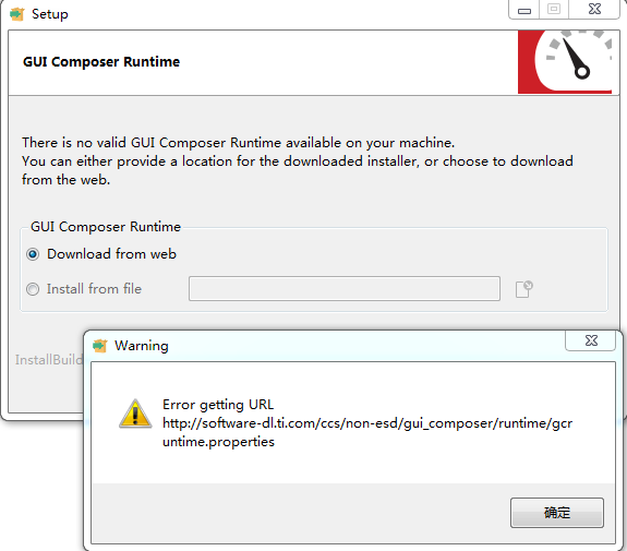

  • Hi guys,
    Do you have any suggestion ?
    BR/Wang Peng
  • Peng,
    What is the error you receive when using the "Download from Web" option when the original DRV8353 installer tries to install the GUI composer runtime?
    -Adam
  • Hi Adam,
    The error is as following:
    BR/Wang Peng
  • Peng,
    Please confirm that you are connected to the internet and not behind a firewall. Is there another network connection you can try?
    -Adam
  • Hi Adam,
    After serveral attempts at home network, the installation is success finally, the problem may related to proxy exist at office network.
    Thanks.
    BR/Wang Peng
