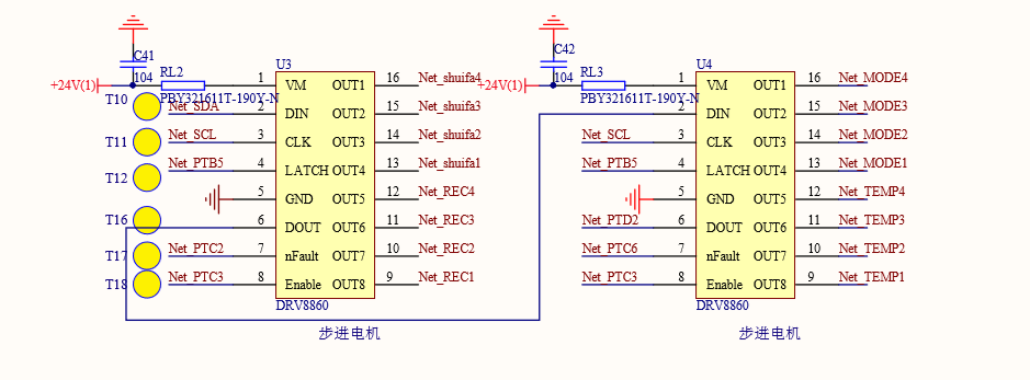

1.Can you help me check the schematic diagram and the corresponding program configuration,
2.Can you Provides DRV8860 EVM board reference code for TI?
3.I can not read the OL fault code, give me some advice? Thank you.

  • Hi Vicky,
    The schematic looks ok.
    Possible problems are the size and location of the bulk capacitors for VM?
    Please note the DRV8860EVM schematic has a 10uF capacitor near each DRV8860 plus the 0.1uF local capacitor.

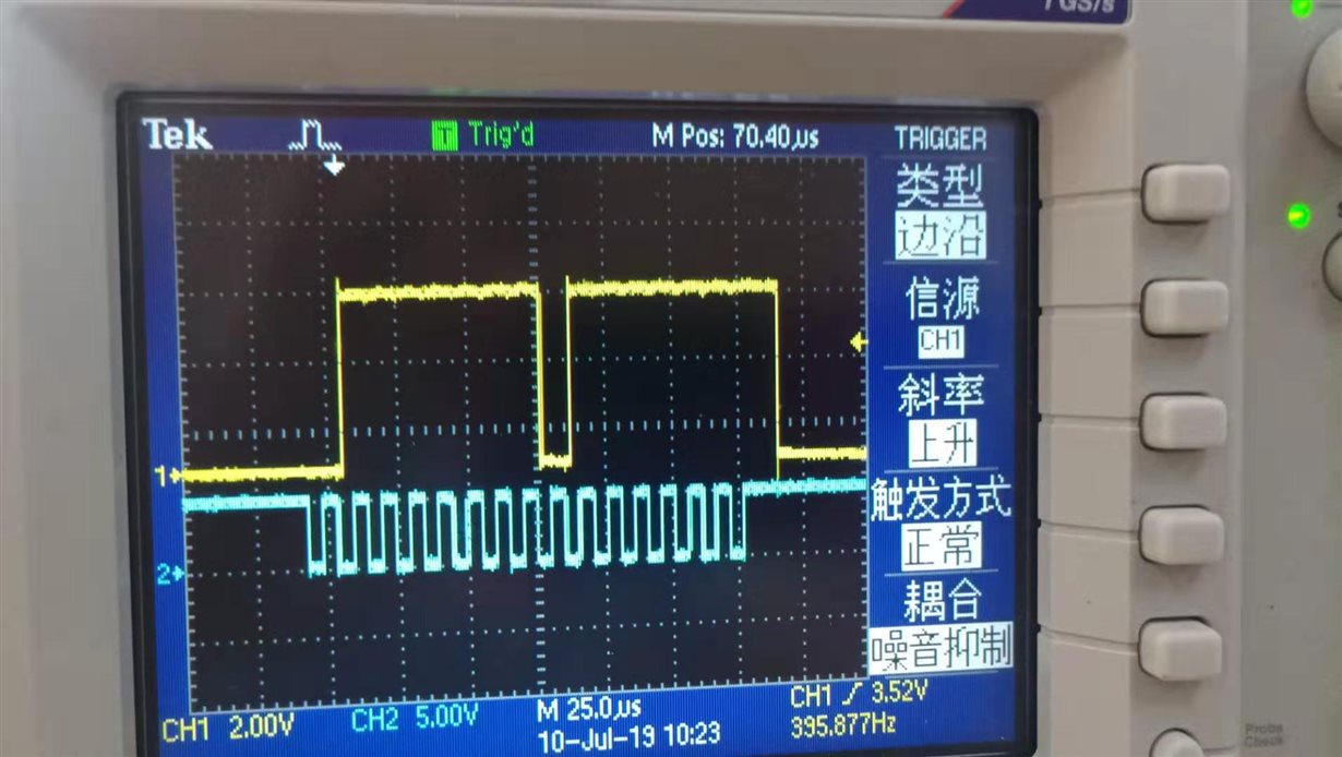

  • Thank you for your help. I can read Fault re code through SPI, but there is a problem.
    The specific steps are as follows:
    1. date reg first writes data
    2. read fault reg can read fault code, oxffff, correct fault location
    3. date reg second writes data, read fault reg can read fault code, oxefef, move. Bit error, continue to read fault reg once, can read the fault code oxffff, position judgment is correct.
    Is there a problem with the SPT driver? The following tests: write date reg: oxffff, read dare reg: ox7f7f. The out foot measured by an oscilloscope is also 0x7f7f. The waveform is shown in the following figure.
    This is all DIN 0xffff, the blue line is clk, and the yellow line is do

  • Hi Eagle,
    Please considered getting a DRV8860EVM to compare the transactions against yours.
    Also, please disconnect the loads if possible.
    Then perform a data register write and data register read using Figures 12 and 25 of the datasheet. Is this working properly? Can you provide a scope capture of both the write and read sequence?
