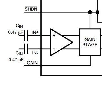

Hi all,

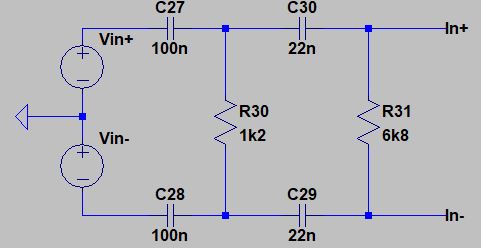

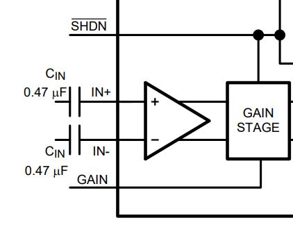

I'm currently using the LM48580 to drive a piezo speaker and this is working quite well. However, I'd like to implement a differential high pass filter before the amplifier and was wondering if in this case the 0.47uF input capacitors Cin that are shown in the datasheet of the LM48580 can be omitted since the HPF will sufficiently block any DC from the inputs?
Here is the filter that I have in mind:
