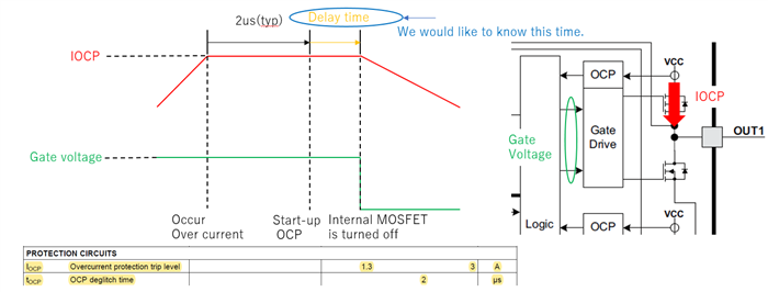

Hi Team,
We understand that if Over current(1.3A to 3.0A) occurs more than 2us(typ), OCP starts up.
Then, I would like to know the period between “Start-up OCP” and “Internal MOSFET is turned off”.
(Please refer to the following “Delay time.)
Could you please let us know if you have any value?
(For example, around OOus, more than OOus etc. )
*This value does not need to be a guarantee.
