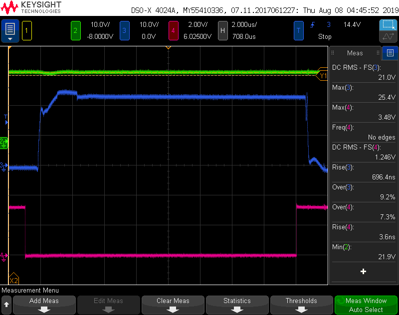

I am using the DRV8872 motor driver to drive a brushed DC motor. Although the motor driver is driving the motor, I am observing bad signals on the motor output line and want to know what is causing this in case it is indicative of an underlying issue.
Here is a scope image of what I am seeing. Blue is one of the motor output lines and pink is the corresponding motor input line (It is the same for the other set of input/output). The motor input is being PWM driven at 20kHz frequency and 25% duty cycle.
If you zoom in, you can see the motor output line exhibits many weird behavior on rising and falling edge.
Is there any explanation for what is causing the motor output signal to look like this? Or suggestion for improvements to correct the behavior.

  • Hi Grace,
    Is a load(motor) connected? If yes, have you tried comparing the signals without a load(motor) connected?
    Is the ITRIP threshold reached during those spikes?
  • Hi Hector,
    Yes, the load is connected. It's a brushed DC motor internal to a linear actuator. I believe that without the load the signals look like straight edges.
    No, I do not believe the ITRIP threshold is reached because I currently am not using an ISENSE resistor (have the pin tied to ground) and the motor stall current is only 2A.
    Thank you.

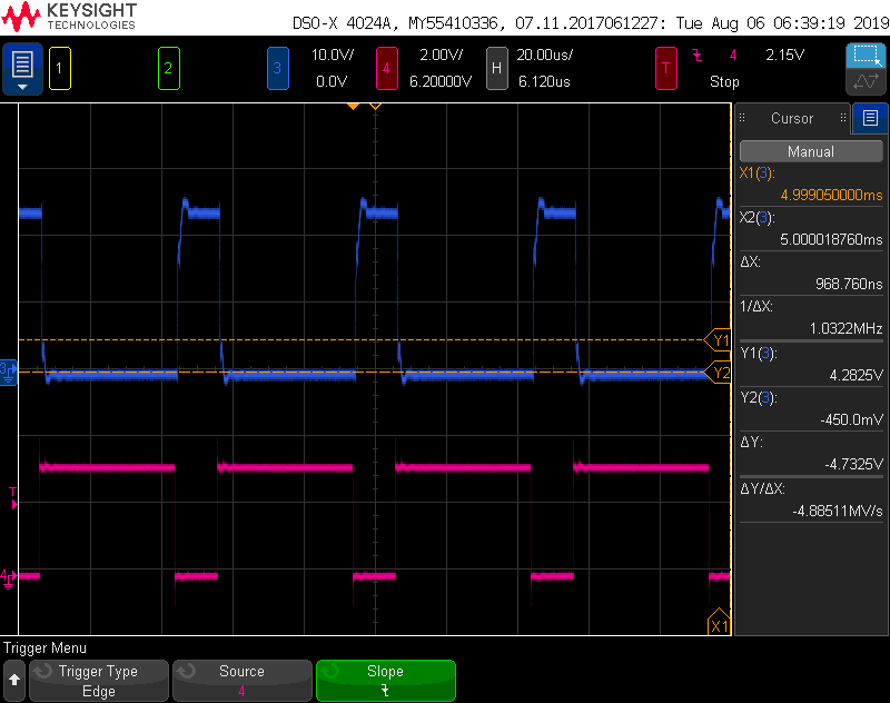

    Due to the setup, it is difficult for me to capture 4 signals on the scope at once. Here is a scope capture of IN1 (pink), OUT2 (blue), and VM (green).
    And zoomed in image:
    Based upon my opinion, this doesn't look like the voltage is sagging enough to indicate large current spike.

    Another thing to note is I have tested an entirely different motor and I do not notice these characteristics with the other motor. In fact the signal looks much better and the edges are smooth. So I'm thinking it has to do with how the original motor is loading the motor driver to cause these weird behaviors so modifications may be necessary. However, I don't know how to characterize the two different motors in order to determine what differing factors between the two motors could be causing this behavior.
    Thank you.

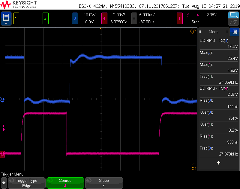

    I did some more testing as this seems to be an issue with the motor driver not able to support certain loads. Using the driver eval board, I put two 1uH inductors in series (so one from each motor driver output to the motor) and that seems to get rid of the weird double-edge. As you can see below, it does introduce some extra ringing.
    So from this, are there any load limitations on the motor driver? Like does the motor driver require some sort of minimum inductive load for it to work properly?

    I have determined the source of the problem. The linear actuator has three 0.1uF capacitors soldered onto the motor terminals (one between the two terminals, one from each terminal to ground). I am assuming these are being used to reduce the motor noise. After I removed these capacitors, all motor driver behavior was normal. I am thinking that during the edge transitions the capacitors weren't able to charge and discharge fast enough so it caused that weird double edge behavior? Do you have any suggested workaround on how to deal with this issue? It would be unreasonable for me to have to remove the capacitors from each motor so I'm wondering if there's some element I can add to the motor driver circuit to help prevent this from happening.
