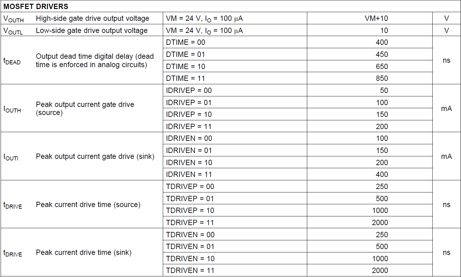

Hi team,
Could you let me know how much current will through  for each AOUT1, AOUT2, BOUT1 and BOUT2?
Or could you provide each impedance value?

  • Shota,
    The output drive current capability are provided in the spec table.
  • Hi Wang-san
    Thanks for quick reply.
    But my customer would like to know current flow in/out at terminal AOUT1, AOUT2, BOUT1, BOUT2.
    Not gate driver sink/source current such as A1HS, A1LS, A2HS, A2LS, B1HS, B1HS, B2HS, B2LS.

  • Shota,
    When high side FETs are turned on, the gate drive current goes out from xxHS and returns back from xOUTx. For example: the gate drive goes out from A1HS and return back from AOUT1. The A1HS gate drive current is same as AOUT1's current.
  • Hi Wang-san
    Let me clarify your answer.
    I thought gate drive current flow into VM or source of FET.
    But this is not correct, actually xOUTx terminal is just not only for monitoring inductance voltage but also sink/source current as much as gate drive current.
    Is this understanding right?
    Shota Mago
  • Correct. According to Kirchhoff current laws, flowing into the FET's gate current is equal to the flowing out current (back to xOUT pin).

    Although I think it's basic question, would it be possible to how did you derive xOUTx current = gate drive current?
    Additionally, could you let me know resistor value which is connected to each xOUTx node to GND as shown in Figure.15?

  • Shota,
    Kirchhoff laws: (https://en.wikipedia.org/wiki/Kirchhoff%27s_circuit_laws)
    For a joint, flowing in current is equal to flowing out current. According to this principle, if you circling a circuit, the flowing in current should be equal to flowing out current.
    So, xOUTx current = gate drive current unless you find other current leakage path. Yes. You can argue the Cgd current vs Cgs current during FET turn-on/off transient. That can make xOUTx current is different than gate drive current. In this case, you have to measure it.  "xOUTx current = gate drive current" just gives you an xOUTx current estimation.
