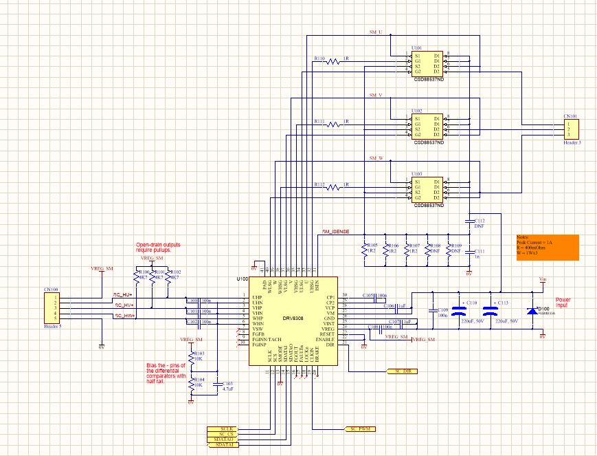

DRV8308: OCP register Issue
Part Number: DRV8308
Other Parts Discussed in Thread: DRV8305
I have a Dual Brushless DC Motor Drive application using an MSP430 and two DRV8308, one driving a 1A motor and the other a 10A motor. I am able to write to the registers over SPI and all seems fine because the both motors runs perfectly. I have configured the ISEN shunt resistors to coincide with 500mV on the OCPTH registers at full current. The application for both motors runs at about 150mV to 200mV during normal running. I can lock the rotor on the smaller motor and the current peaks to 1A, but then drops to around 0.5A (500mV).
I am trying to use the 0x2A register to determine over-current. However, despite reading the register in a loop, I always read 0x18 (UVLO & CPFAIL). I have tried clearing the 0x2A register by writing 0x00, but get the same result. I would like to be able to determine over-current on the motor to ensure the application does not go into locked rotor in the field.
Please can you assist?

  • Hi Adam
    Thanks very much for your response. with the moto off, Vm=Vcp=Cp2=24V. When I enable the motor, Vm is stable at 24V, Vcp rises to 34.2V and Cp2 is 23.9V. I have tried writing to 0x2A after initialising, as well as after I start the motor. I assume my reading and writing to the registers is correct as the motor behave predictably according to the registers I change. Please find my register values and code below:-
    Initialising procedure

  • Hi Adam
    Just one more thing. I used an app note circuit, and did not connect the FAULTn pin (regret doing this now). However, if this pin is left unconnected, will it have an effect. See schematic below.
  • Warren,
    I am unable to review the code unfortunately.
    I would connect the Fault pin if possible, it will help in debugging immensely.
    -Adam
  • Thanks for your help Adam.
    Connecting the FAULTn pin no is a challenge. Do you know if the pin will affect the 0x2A register - i.e. if the pin is floating, will the OCP flag still be set in an overcurrent condition?
    Do you know who could assist with the code?
    Warren
  • Warren,
    Leaving the nFAULT pin floating is not an issue, it just tells us more specifically if the driver is active or in fault. If the driver is operating but the 0x2A register is showing faults then these are old faults that need to be cleared.
    You may be able to post in the forum for the MCU you are using.
    -Adam
