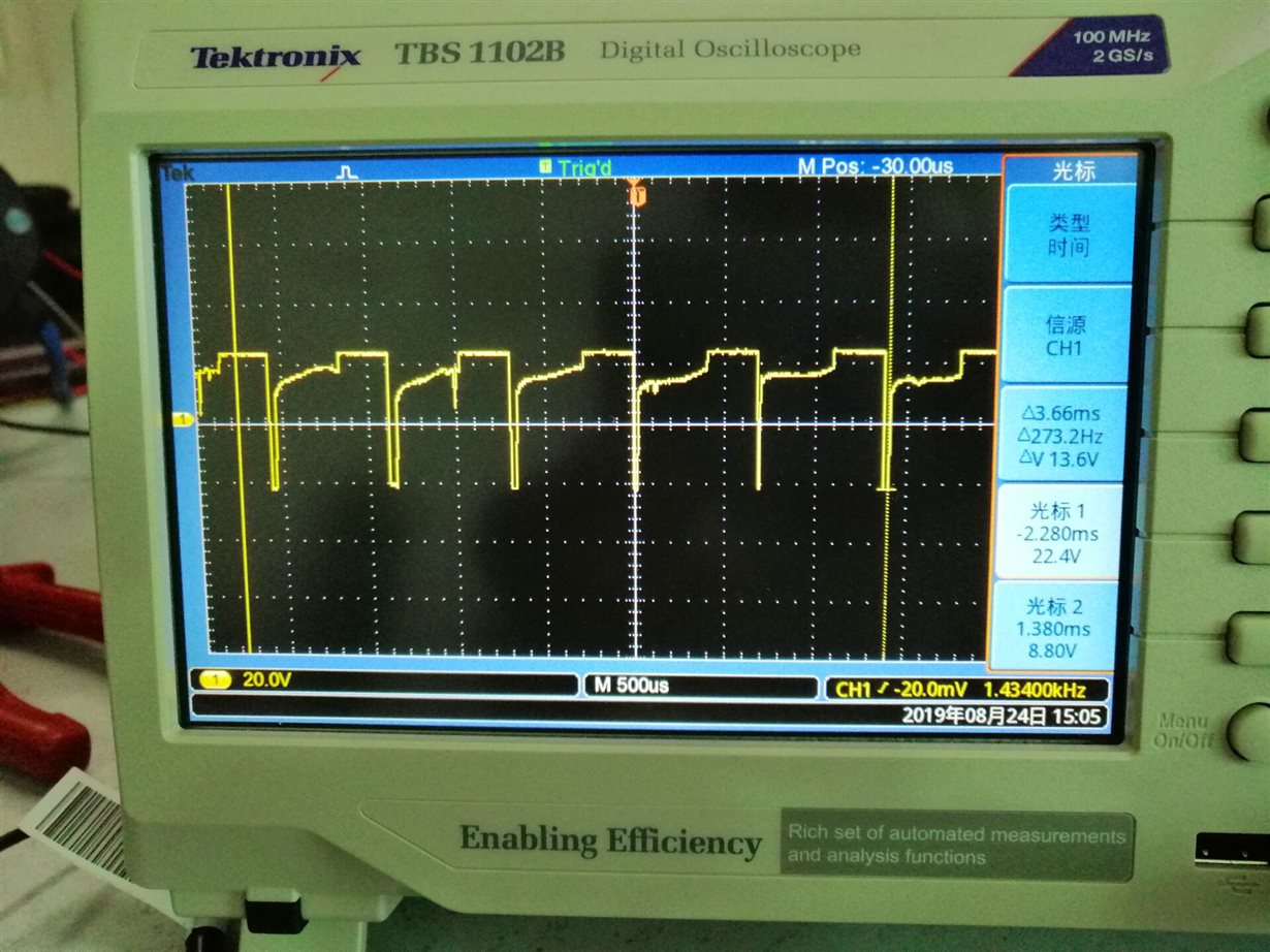

What is the output waveform with motor of the out+ and out- of the DRV8800?

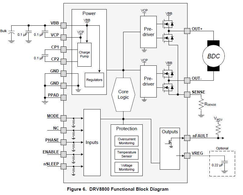

1. Is it possible to collect the current of the chip in the pin8? He uses the single chip to collect. If it is possible, what does he need to pay attention to?

Do they close the waveform issue?

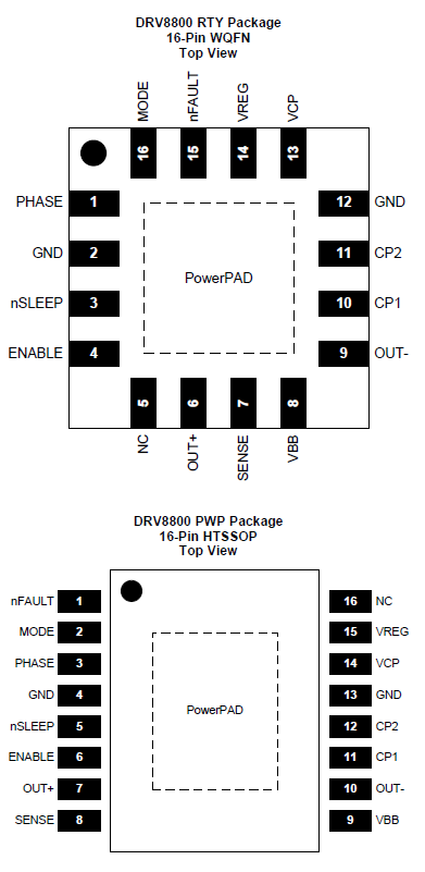

The DRV8800 PWP package's pin 8 is different than QFN package's pin 8.

I'm sorry to say that customer has not told me if the waveform issue has been solved.

Customer wants to know is it possible to get the working current of the motor using Pin8?

Sorry, I mean the DRV8800 PWP package's pin 8 is different than QFN package's pin 8. I have updated the previous post.
Assume it is PWP package, the pin 8 is 'Sense' pin. The motor winding current goes through the sense resistor (see figure 6). Customers can add their own circuit to collect or measure the working current from it.
