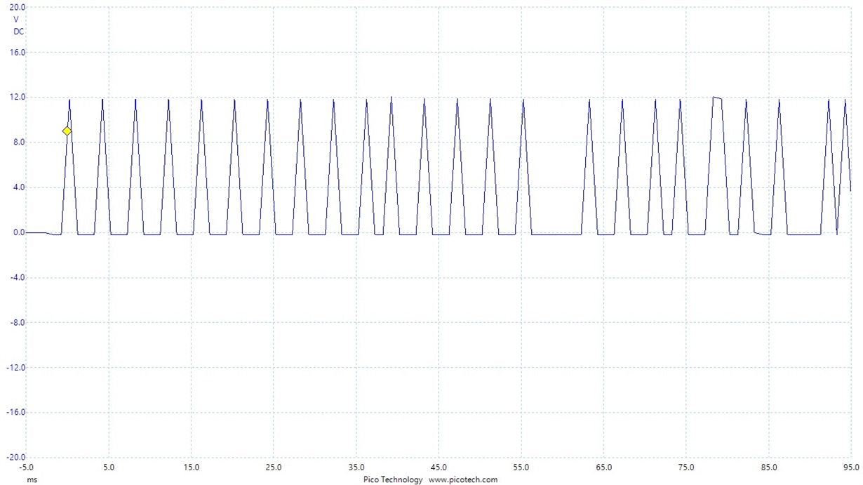

DRV120: No peak in output, strait to PWM
Part Number: DRV120
Summary
I am trying to use a DRV120 to drive an SMC LVM105R solenoid valve on a prototype board.  The output is an unexpected result and the valve does not operate.  The chip goes strait into PWM mode with no time for the current to rise.

The DRV120 is configured for the maximum current with the following specs and schematic
DRV120APWR (14pin package)
V_IN = 12V
C_KEEP = 2.2uF
R_PEAK = 50k-ohm
R_HOLD = 50k-ohm
R_OSC = 100k-ohm
Output
When the EN pin goes high, the voltage a across the solenoid is measured and displayed bellow.  The current is not allowed to rise, and the chip goes direclty to PWM mode.  The solenoid does not actuate.
Questions
Can the DRV120 opperate this valve?
If so, what settings should we use?

  • Hi Gabriel,
    Please check the enable voltage, seems to me the high level is between max low and min high. The external pull down resistor is too strong-50kohm.
    Enable should be >1.65V and the internal pull down R~250kohm
    Another observation is keep time, it is to fast for L=4H, R=34ohm,V=12V, I=0.25A, needs more time to ramp up the current.
     Based on solenoid spec the ramp up time is faster than 10mS, maybe the inductance and/or resistance is smaller
    DRV120 can drive the solenoid based on datasheet characteristics.
