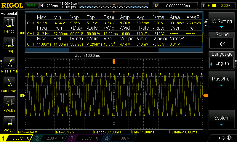

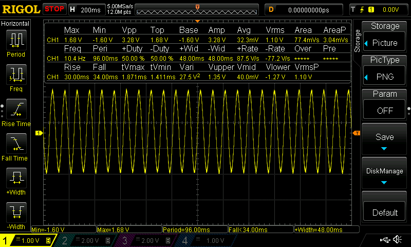

  • Hi Andy,
    This motor behavior usually results from 3 sources: incorrectly programmed Phase Resistance, incorrectly programmed Kt, and Tcontrol (lead time).
    Phase to Phase resistance is found by taking a digital multimeter and measuring the resistance between any of the two phase wires, and phase resistance will be half the phase to phase resistance:
    R_ph_ph / 2 = R_ph_ct
    For Kt, we highly recommend finding that number by taking a scope probe between two of the phases, physically rotate the motor, and measure Voltage (peak to peak) and frequency of the BEMF. Then, Kt will come from dividing the peak to peak voltage by to 2 and dividing by frequency:
    Kt = (V_pk_pk/2)/(f_BEMF)
    For Tcontrol, go to the Control Advance Time Fine Tune section in the tuning guide and follow the instructions there. Tcontrol usually ranges between 30us to 450us.
    All of these steps (and more) are reiterated in tuning guide:
    DRV10983:
    Michael

  • Thanks for getting back to me Michael. I have verified the kt value. I calculated a value of around 157, which is in the lookup table between 0x4a and 0x4b. We are running with a value of 0x49. Do you think that is the cause? As to the failure mode that requires power cycling to recover from, I saw on this forum where Cole said that noise on the phases can be coupled into the BEMF phase comparators, causing problems with ISD and resulting in the device then being "stuck in a loop." One diagnostic path was to check for values in spdCmdBuffer when the motor isn't running. Our setup never has zero values in spdCmdBuffer or MotorSpeed, even when then control voltage has been zero for several minutes. When it gets "stuck" like this, is there a means to recover using the attached microcontroller, to say temporarily disable ISD, or some other preferred practice? Thanks for your help.

  • Hi Andy,
    1. I think this issue can be resolved by slowing down your deceleration or your motor might not be giving the device enough signal to properly commutate the motor at lower speeds.
    2. The device is reading some signals on its phases when it tries to start up again even though the motor is not spinning that tell the device the motor is spinning. this can be solved by two methods, one is to disable ISD and the other is to improve the layout so that there is not this noise on the phases.
    Michael
