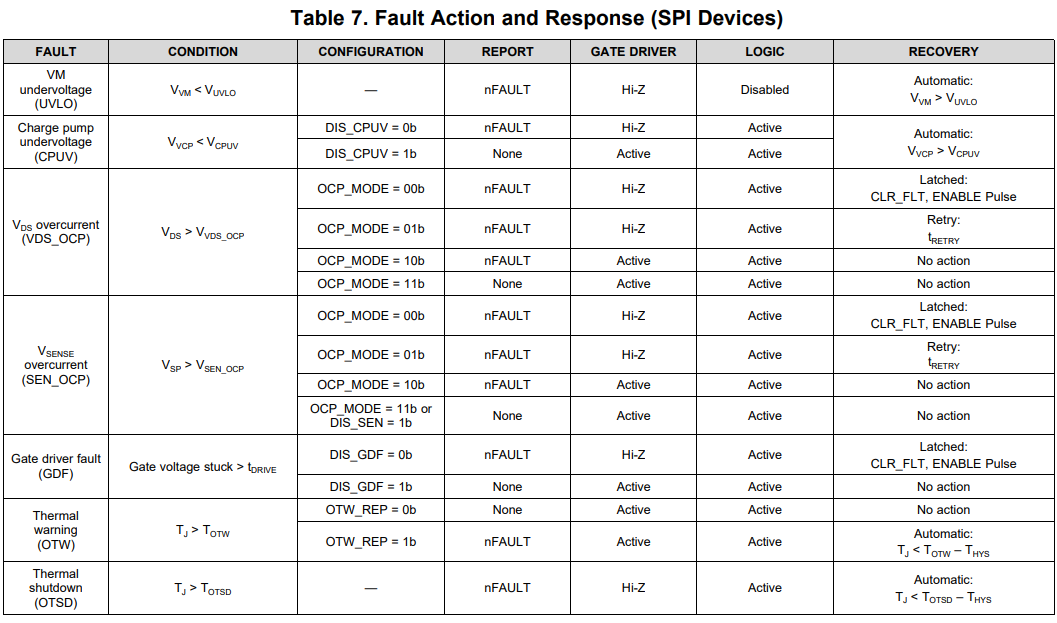

  • Kengo,
    Please check this table in the datasheet:
    The VGS fault is listed above as GDF, as you can see, if DIS_GDF is 0, then the nFAULT pin will report.
    Some customers choose to disable GDF when they are using some strange dead time or independently controlling the HS and LS FET.
    There is no normal reason to disable GDF because without it there can be shoot-through.
    -Adam
