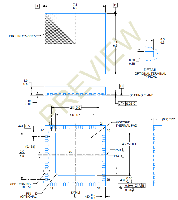

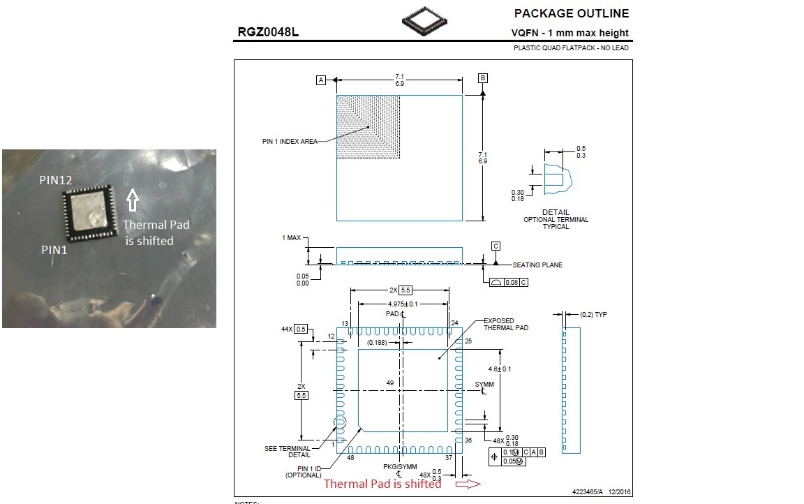

We ordered DRV8350RH chip.

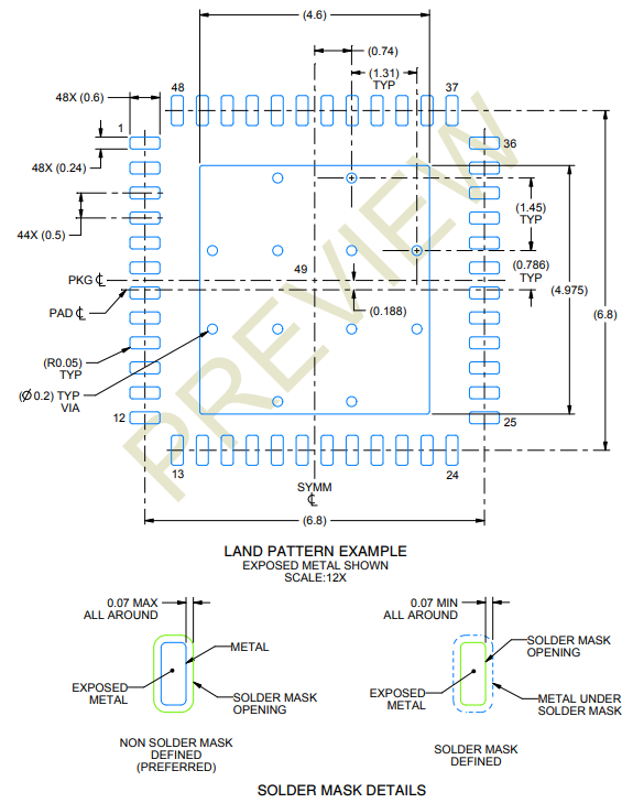

We followed the datasheet board layout suggestion, but then we found out the thermal pad on the chip does not match the datasheet layout outline.
Can someone check the datasheet?

Candy,
The datasheet has been corrected and is now live:
http://www.ti.com/lit/ds/symlink/drv8353.pdf
-Adam
