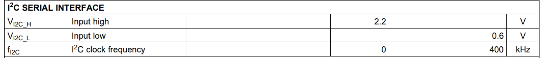

does I2C-interface of the DRV10987 is compliant to the I2C-standard with regard to the electrical specification?
I read in the datasheet VI2C_L, Inputlow, is maximum 0.6 volts.
The I2C standard says the maximum low level input voltage is 0.3xVDD. For 3.3 volts supply this would mean 0.99 volts max low level input voltage.
I want to use an I2C isolator and this chips has the output low spec min 600mV to max 900mV on one side.
Is the datasheet of the DRV10987 really true in this case?

    The DRV10987's I2C interface will follow the following section of the datasheet:
    What I2C isolator are you using and I can check if it will be compatible with our device?
    Michael

  • Hi Christoph,
    The side 2 should be compatible with the DRV10987 since the Logic low output voltage is at max .4V and the DRV10987's input low voltage is .6V.

  • Hi Chistoph,
    I think the DRV10987 will work with side 1 of the ADUM1250 because in the datasheet I think they are assuming you are using a small resistor pull up of 1K rather than the 4.7K that we recommend for our device. This means that the ADUM1250 will have to pull less current and will have a lower output voltage. I can not say for certain though because their datasheet is unclear.
    In their datasheet they say that their device's Side 1 is I2C compatible and Side 2 is I2C Compliant.  Our device is I2C compatible as well, so I do not think I can definitively say that the I2C compatible side 1 and our I2C compatible interface will be able to work across all implementations. but I can say that they will probably work with a 4.7K pull down.
