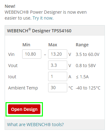

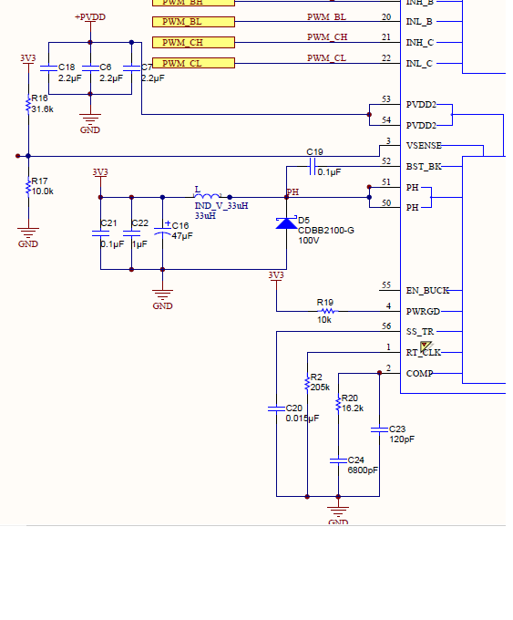

I designed DRV8301 Buck converter for gives 3.3V but I get 5.6V output. My design look pic.
Later I tried to change my DRV8301 Launchpad components to my new design again get 5.6V output.
And I reassembled the components on the EVM and it was giving 5.6V output on the EVM.

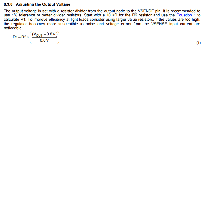

And I tried now Vsense input resistors calculation like TPS54160 and I give change output 0.2V-0.8V
How is it?
