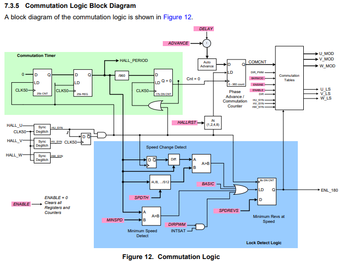

    There is no closed loop current control built into the device. The only closed loop control available uses the speed, FG, and lock to control the commutation and similar. This is documented in the datasheet as follows:
    Tuning will involve the pink signals and registers as seen above, they are described in the datasheet in length.
    -Adam

  • Xiaolan,
    1/2. There is no speed command profile or ramp rate, this will need to be implemented in your control software or MCU.
    3. Depending on the state of FGSEL, the DRV8308 will either use the FGIN signal or HALL inputs to check for a constant speed, once the variation of the chosen input is below a certain threshold, the driver assumes a constant speed has been reached.
    4/5/6/7/9. Please see section "4.1 Key Registers" of the DRV8308 User's Guide here: http://www.ti.com/lit/ug/slvua41f/slvua41f.pdf
    8. IDRIVE is simply the current control for the FET gates which in turn controls the slew rate of the output. This has nothing to do with the control loop or any motor physics.
    10. This is described in the previous section in the datasheet.
    -Adam
