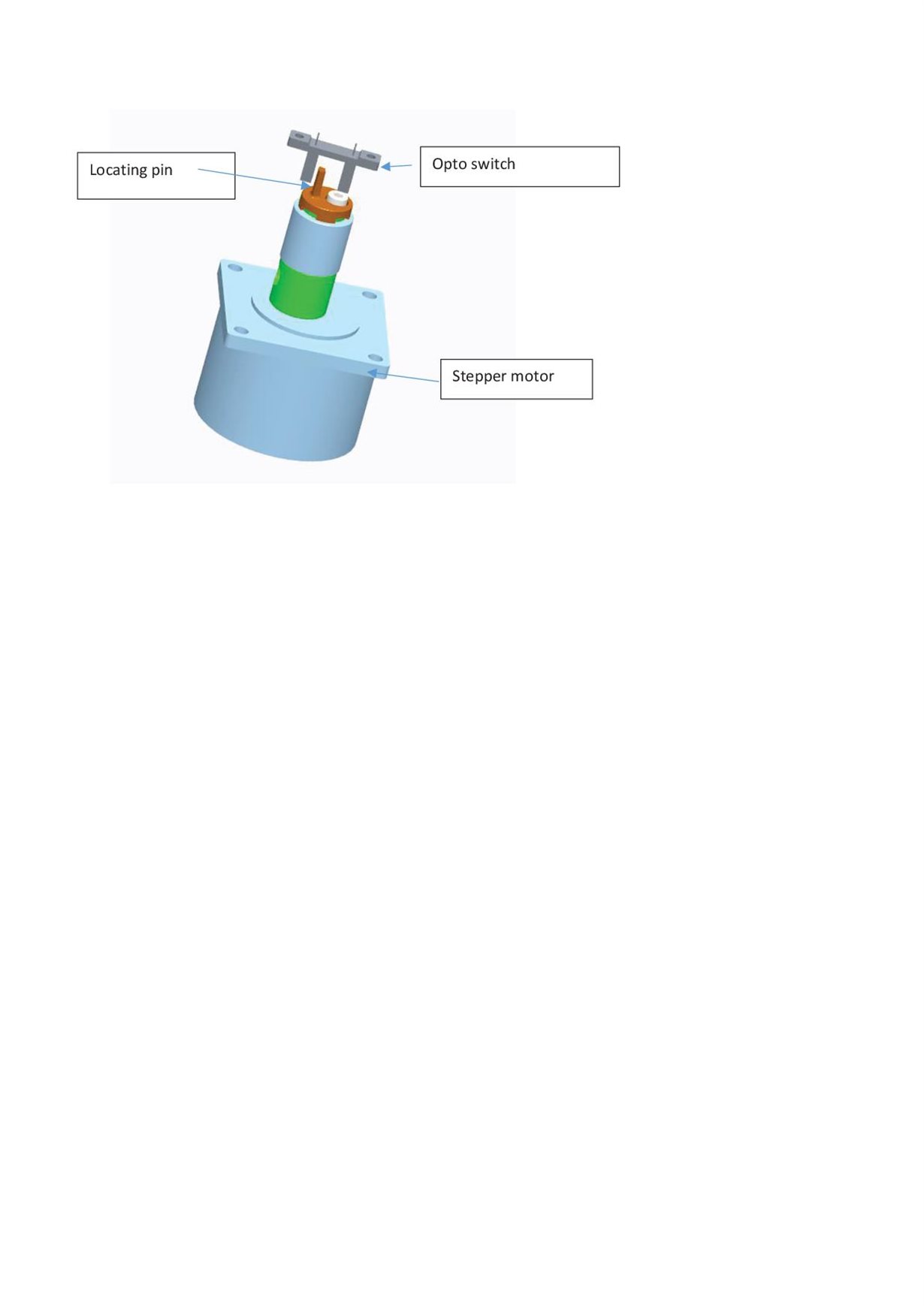

I manage a stepper motor (MINEBEA 23KM  1.5A/phase  1.8°step angle)     with your driver DRV8818.
If I made a full rotation  (200 steps), it is OK ( RESETn active) , but for the following rotations, I lose one step
The solution is to manage the RESETn  signal  together with ENABLEn signal.

  • Hi Rick
    The following test was made with a connection between RESETn and ENABLEn via an inverter
    I send you a graph with HOMEn signal, we count  50 falling edges  ( 50 x 4 states in full step = 200 steps)
    The optical detection is the signal coming from an optical switch .
    The locating pin,  fixed on the axis of the stepper motor,  cut or not the IR beam of the optical switch
    So, I am able to confirm that the time between the rising edge of OPTO DETECTION and STEP signal does not vary, even after 100   full rotations
