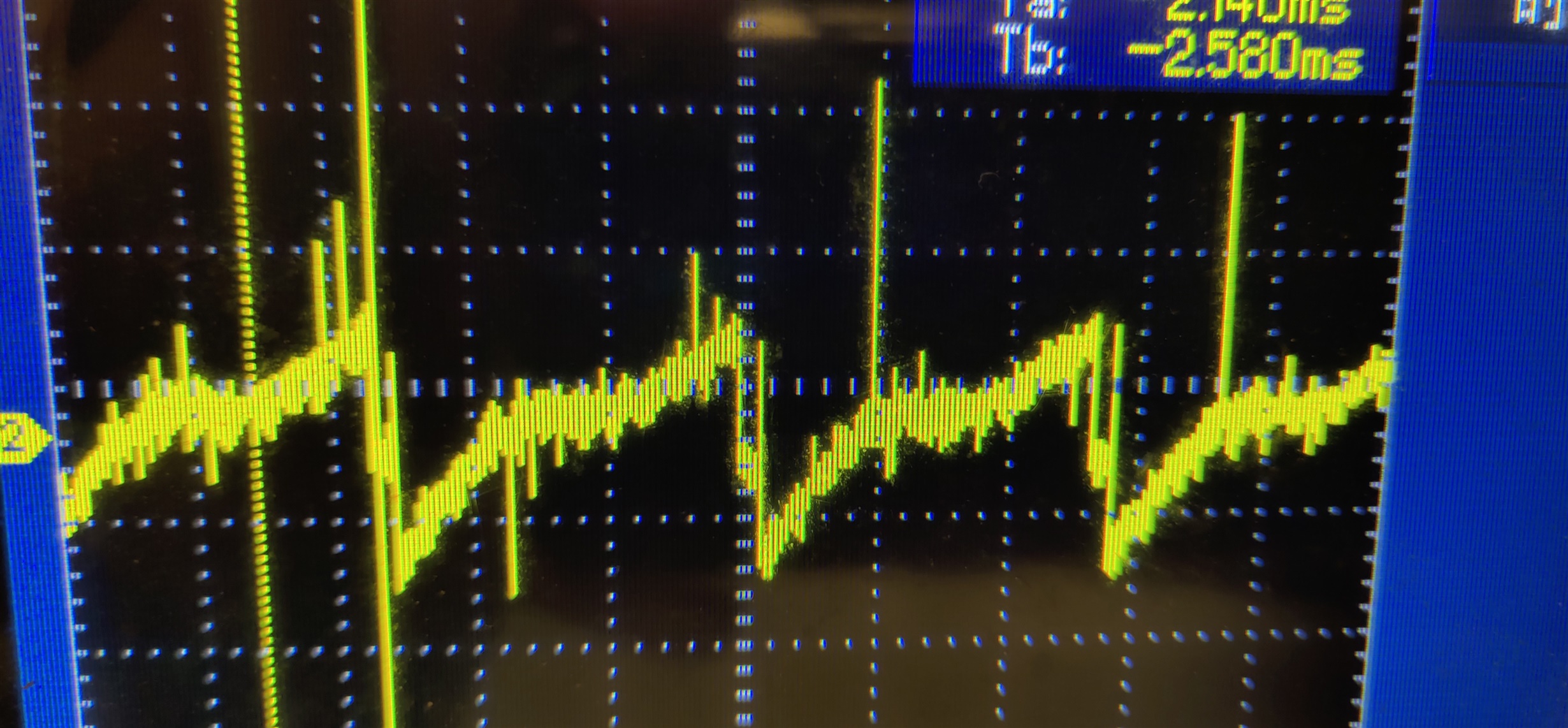

i using the testing pen to link the AISENP and BISENP (the postive link the AISENP,negative link the BISENP). the waveform is sinusoidal. and Is this connection correct ?
The AISENP to ground waveform is not sinusoidal waveform. To me, the current is below the indexer current setting. When the motor is spinning too fast or the input voltage too low, you may see that waveform.
So, please slow down the step rate and make the input voltage higher.
