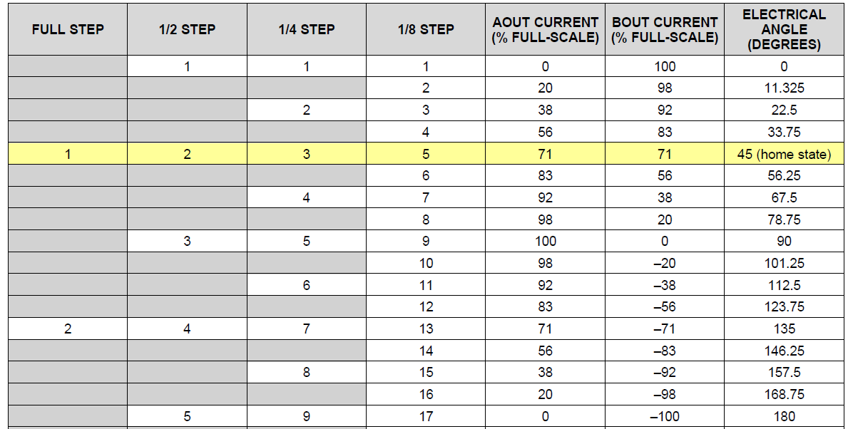

    Could you help my understanding me with a case study?
    What is the min and max detection time for the following cases?
    Step Angle : 1.8 dgree
    STEP : 10kHz
    SDCNT : 00; STALLn asserted on first step with back EMF below SDTHR
    SMPLTH : 001; 100 µs
    Takashi Onawa
  • Onawa-san,
    "The time between step inputs must be greater than SMPLTH time for back EMF sampling." (Datasheet page 23)
    If the step rate is 10kHz, each step is 100us. SMPLTH time should be 50us.
    SDCNT=00: STALLn asserted on first step with back EMF below SDTHR. Back EMF is sensed during a zero-current step and at the end of 50us SMPLTH time.
    Assume the customer picks 1/8micro-step; the motor is stop or stuck at step 2 and the step pin pulse rate is 10kHz (each micro-step is about 100us), Running to next zero-current step needs 15 step pulses. So, the detection time is 15*100us+50us=1550us.
    Assume the customer picks 1/8micro-step; the motor is stop or stuck at step 2 and the step pin pulse rate is 10kHz (each micro-step is about 100us), Running to next zero-current step needs 15 step pulses. So, the detection time is 1*100us+50us=150us.
    From here we can see, SDCNT setting, where the motor stops, micro-step setting and step rate affects the detection time.
    BTW, I would like to set SDCNT=01 or up to avoid any back EMF sensing noise concern.
