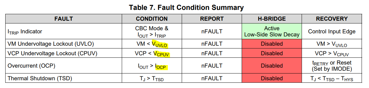

I`ve bought some pre-released DRV8874-Q1 for testing, according to the evaluation board of it, it can bear continuous current of 3.3A as suggested on datasheet,
but on my designed board in PWM mode, as I tested it in 12V/3A, it can only run for about 7 sec;
for 12V/3.3A it can only run for 3 sec then the fault LED started to blink, current will drop,
is this problem of heat dissipate problem of my board or some other issue, can you me some advice??
