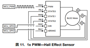

DRV8343-Q1: Output disable until 6xPWM mode to 1xPWM mode
Part Number: DRV8343-Q1
Hi Team,
My customer plan to use DRV8343S under 1PWM with hall sensor, like following figure. Now they are annoyed by a noise from Hall sensor at  initialization timing at start up. They don't want anything to be output while changing the device register from 6XPWM mode to 1xPWM mode.
They want to disable the gate driver output  during register initialization though,  Is there any way?
