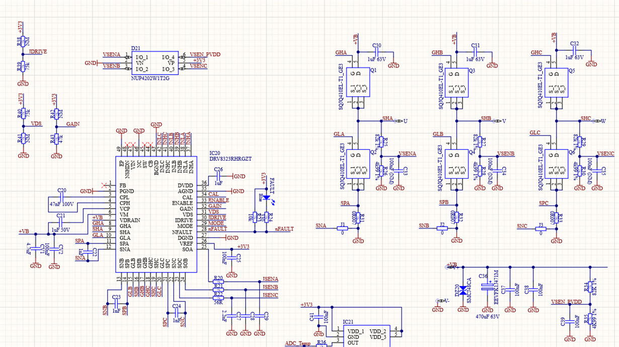

Hi guys,
I've a strange problem with a custom board.
I'm using DRV8323RH and a F28069M. I made a simple brushless sensorless torque control.
You can see the "power drive" schematic attached to this post.
I've control all over the pins and I don't see strange behaviors. So, I'm trying to use a modded version of "motorware lab5a".
When I set "gMotorVars.Flag_enableSys" flag always it's ok.
When I set "gMotorVars.Flag_Run_Identify" flag nFAULT goes on and the driver latch to error condition. I try to reset with a pulse on ENABLE pin but the nFAULT condition immediately reappears.
In this condition if I control the MCU with the Oscilloscope I can see the PWM signals over all "MOS gate" signals.
Someone can help me debug this issue?

- Internal Buck regulator: NOT USED;
- Voltage +VB : +48Vdc;
- MODE Pin: set to GND (6x PWM);
- VDS control: disable...VDS tied to VDD (at the moment...);

    Can you confirm the IDRIVE setting you are using?
    The schematic shows 60/120mA setting and FETs with 20nC of Qgd.

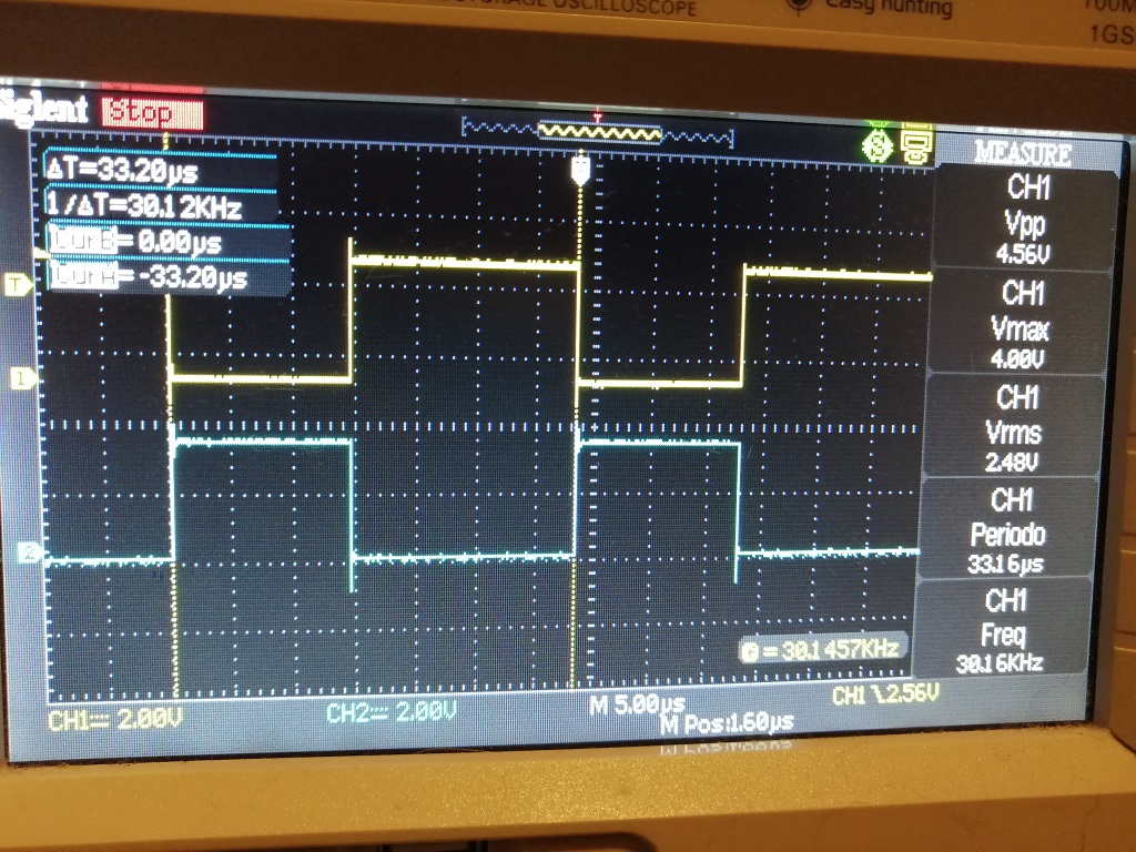

  • Hi Adam,
    sorry for my bad english.
    I try to explain my statement.
    Whit only "Flag_enableSys" set the PWM signals are not generated from MCU. When I set also "Flag_Run_Identify" MCU start to generate PWMs signals on pwm1a, pwm1b, pwm2a, pwm2b, pwm3a and pwm3c. At the same time DRV set FAULT pin...but PWM signal coming from MCU are still present in DRV inputs (INHA, INLA, INHB, INLB, INHC, INLC). I checked with oscilloscope these signals (see the pic attached: PHASE A, INHA, INLA). The switching freq is set to 30KHz.
    Can be an hardware issue? I don't use buck regulator and I've not connected these pins (see the schematic upward).
  • Hi Adam,
    I noticed a problem in MOS component library (GATE pinout).
    I downloaded this from "mouser" website but I think it may be wrong.
    Please can you check my schematic and the datasheet:
    Can you confirm my thesis?! Gate pin seems to be in position 4 instead of 1.
  • Stefano,
    The pinout on the Vishay datasheet shows pin 1 as the gate, your schematic shows pin 4 as the gate, this would explain why you are seeing the fault as the gate signal is connected to your source connection at all times through the FET internally.
    You can confirm this by removing all your FETs and retrying your experiment.
