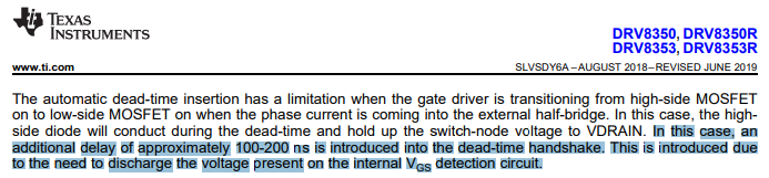

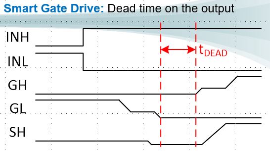

1.What value should the VDS voltage be set to start the dead time?
  This mean is we'd like to get as close to the set value as possible..

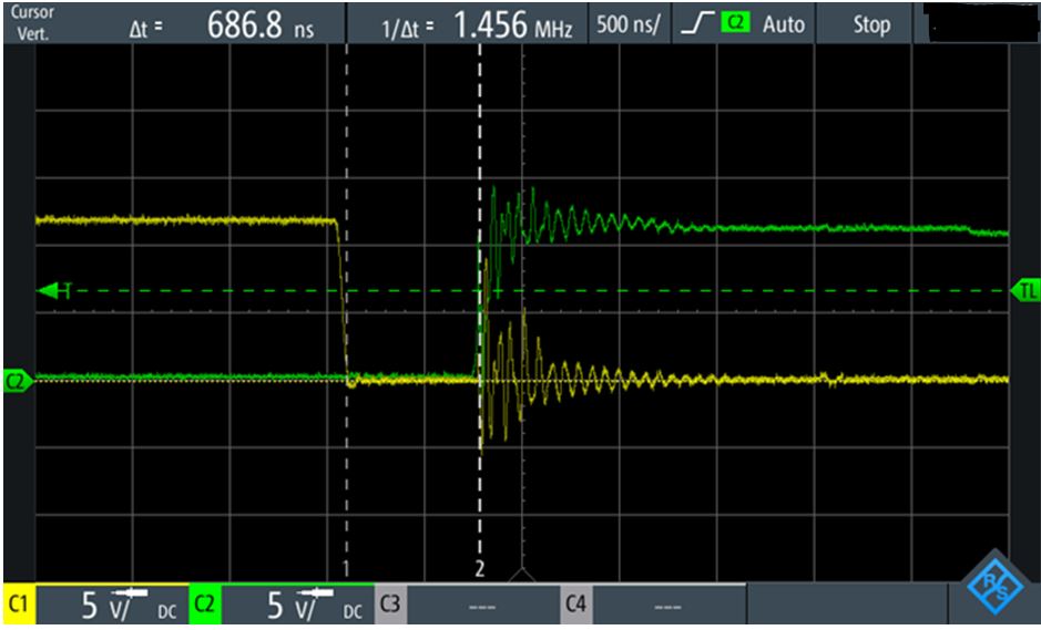

2.Even if we adjust IDrive,, we get a 200nS difference.(we set 400nS but it is 680nS)
Sincerely.
